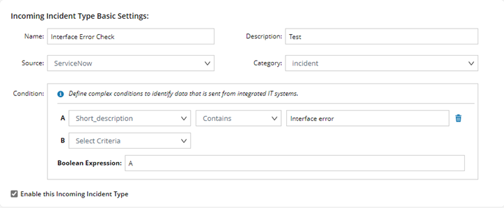

- In the New Incoming Incident Type window, define the basic settings:
• Name: a unique name for the incoming incident type, such as Interface Error Check, BGP Down, etc.
• Description: an optional field to describe the Incident.
• Source: select an Integrated IT system, such as ServiceNow.
• Category: select a source category, such as Incident (Incident ticket from ServiceNow).
• Condition: defining which API calls of this category coming from the source belongs to this Incident Type.
To define a simple condition:
- Select a data field of the API call, for example, Short_description.
- You can also create a custom variable to retrieve the value from the data field by regular expression. The custom variable starts with $. For more information, see Custom Variable in TAF.
- Select an operator (contains, does not contain, matches, does not match, is not null). For example, you can choose Contains.
- Enter a keyword. For example, you can enter Interface error.
Tip: You can combine multiple simple conditions with the standard Boolean AND/OR operations.

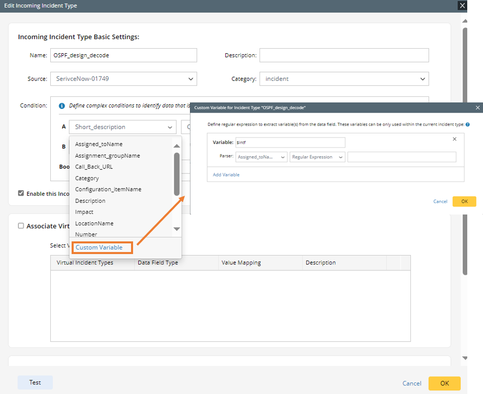

- Define custom variable when create/edit incoming incident type.
- Define custom variable when defining triggered automation.

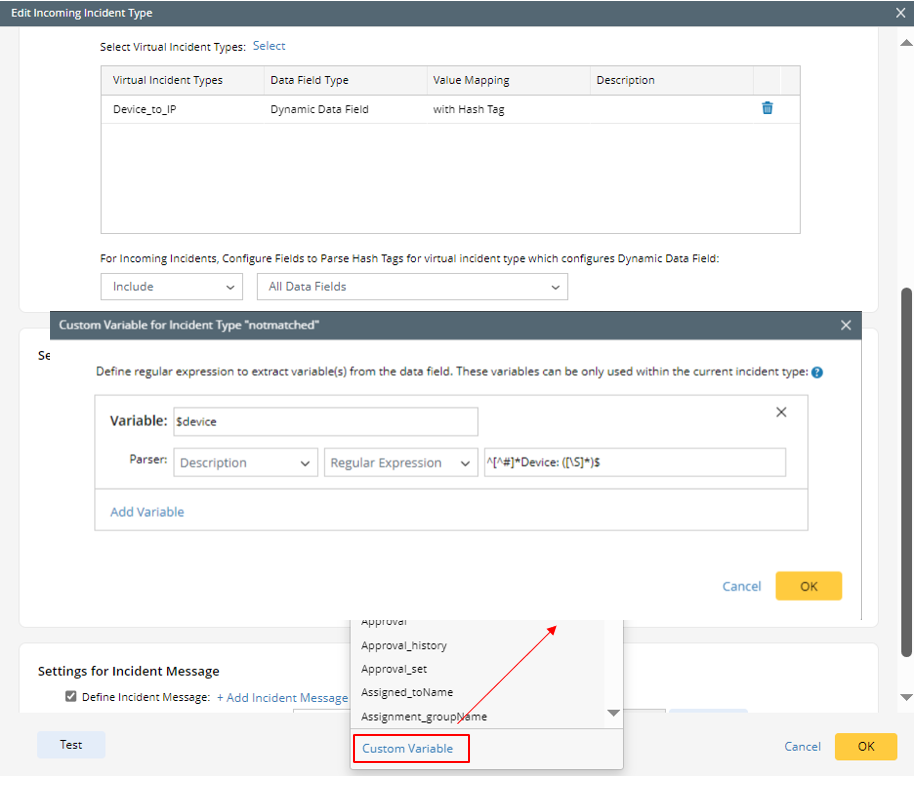

Example: You can create a custom variable to retrieve the value from the data field by regular expression. The following example aims to get the device information (for example "Device: BJ-R1") from the description of the original ticket
- Click
of Condition A in the Condition section, then select Custom Variable. - In the pop-up window, define the following:
- In the Variable field, type the variable name "$device" for the custom variable (note that the custom variable starts with $).
- In the Parser field, set to parse "Description" data by regular expression "^[^#]*Device: ([\S]*)$".
- Click OK. Then you will get the device variable value "BJ-R1".
