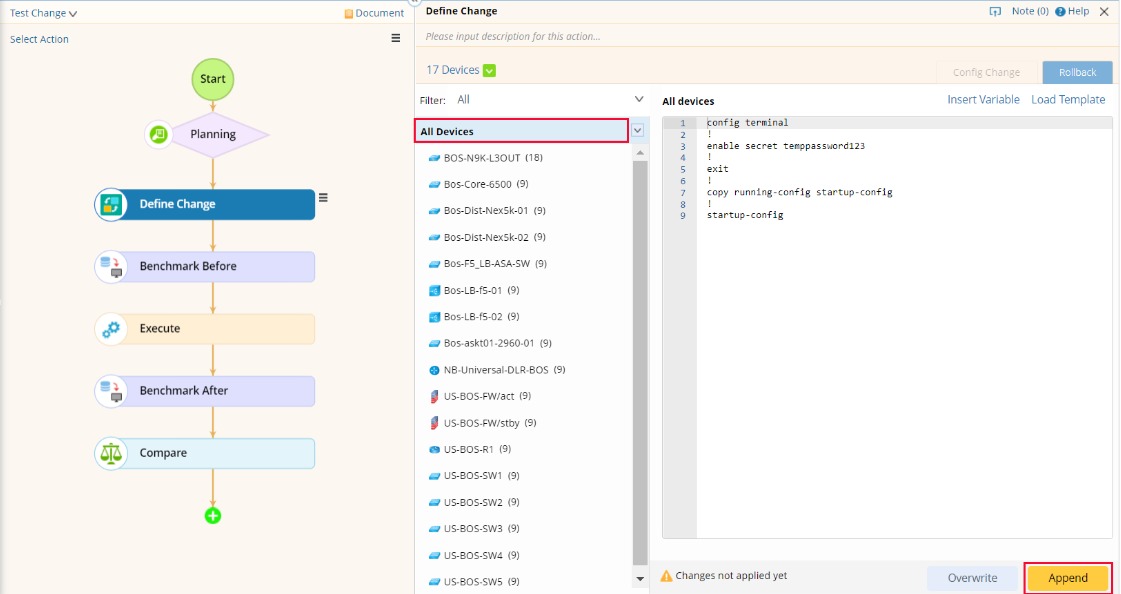

    3. Click Config Change and enter the commands you want to execute on the target devices.

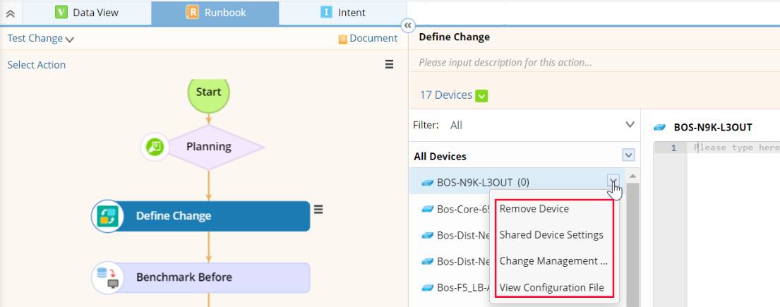

    4. Information Tip: Point to a device and click      to select more options: Remove Device, Shared Device Settings, Change Management Login, View Configuration File.

    5. All Devices and click Append to add the command to all device.
      Information Tip: You can click Load Template and select a predefined configuration template. To create a new configuration template, see Managing Configuration Templates for details.
      Information Note: You need to define the new variables before proceeding. Click the new variable and define it in the pop-up window.
    Information Tip: To clear the applied change command to all devices, click All Devices and click Overwrite.
