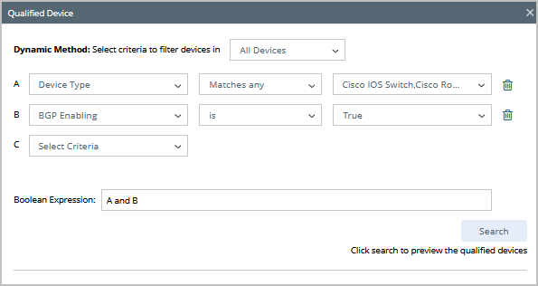

- Define via Dynamic Search method: Define the qualified devices via conditions. For more information, see Dynamic Search.
Select All Devices, then define the conditions and expression.- You can also define the target devices using Static Method.

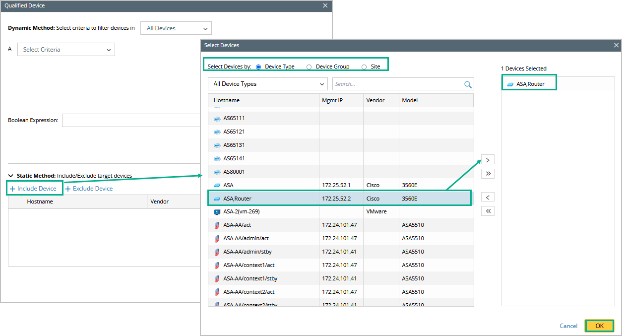

- Under the Static method you can Include and Exclude the devices. When you click + Include Devices, you can see the Select Device window.
- As per your preference you can select the Hostname.
- Click ">" to add that hostname into the right pane and then click OK. You can select multiple hostname and to add them into the right pane.

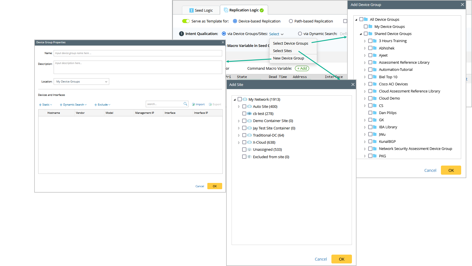

- Define via Device Groups/Sites method: Qualify devices by the defined device groups, Sites, or you can create new device group.

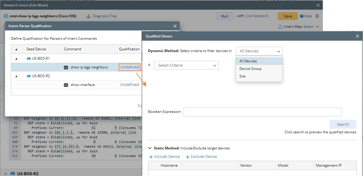

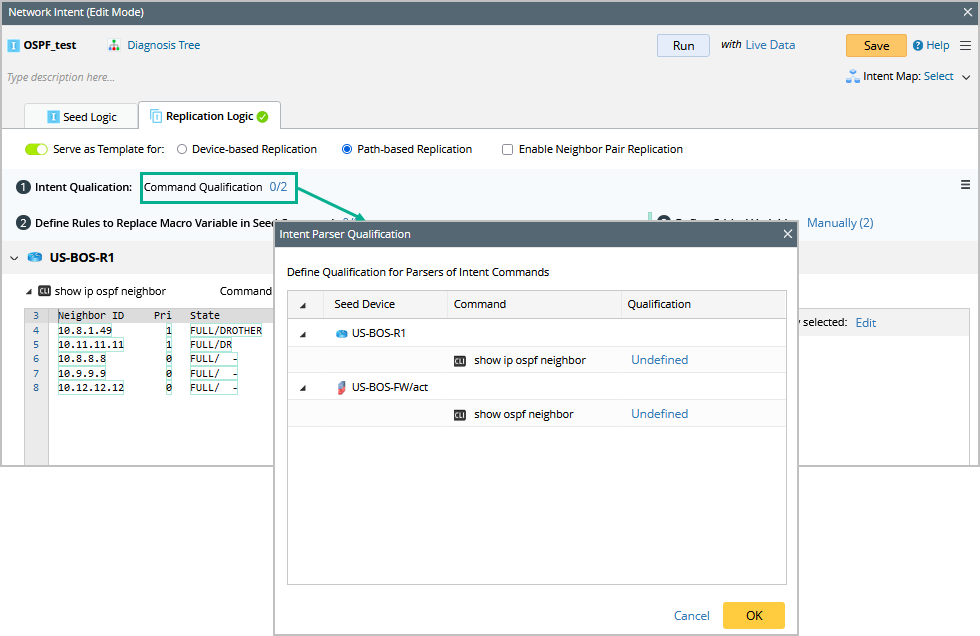

You can also define via Command Qualification.
- In the Intent Qualification section, click the Command Qualification hyperlink (0/2) to define Intent Parser Qualification.
- Click Undefined in the Intent Parser Qualification dialog.
- Define the device qualification. See Define via Dynamic Search for more details.
