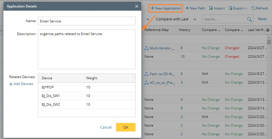

  1. Click the start menu   and then select Application Manager.
  2. Click New Application at the upper-right corner and define the details as follows:
    1. Enter a meaningful name for the application, such as Email Service.
    2. (Optional) Add a description of the application.
    3. (Optional) Add related devices to the application and define a weight for each device.
      Information Tip: Each related device has a default weight value of 10, and you can double-click to modify the value. The weight is used to sort the application list order. See Application Weight for details.
    4. Click OK.
    5. Repeat to add more applications.
