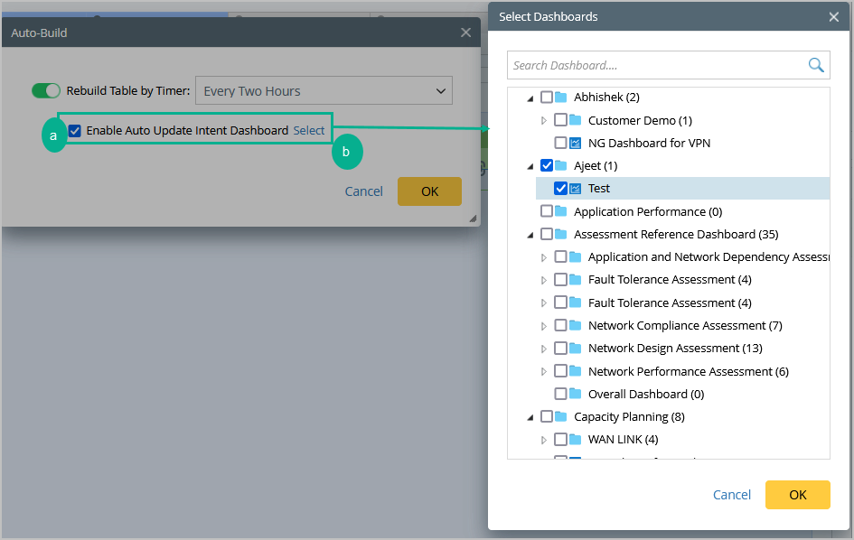

To use the Auto-Build functionality, complete the following steps:
From Base tab or Group tab in the Automation Data Table Builder, click Auto-Build.
  1. In the pop-up Auto-Build dialog, choose any one of the option from the following list:
    1. Turn on Rebuild Table by Timer, then select a proper Timer available in the system.
    2. You can remove the selected timer by clicking Remove Selected Timer.
    3. If the existing Timers cannot meet requirement, you can set up a new timer. Click Add Execution Timer and set up a Timer in the dialog. Then click OK, and the created Timer can be selected for automatically building ADT data.
  2. You can Auto update after building the contents of ADT:
    1. Select the Enable Update Intent Dashboard checkbox.
    2. Click Select and then select a dashboard from the Select Dashboards window.
  3. Click OK in the Auto-Build dialog to set up Auto-Build.

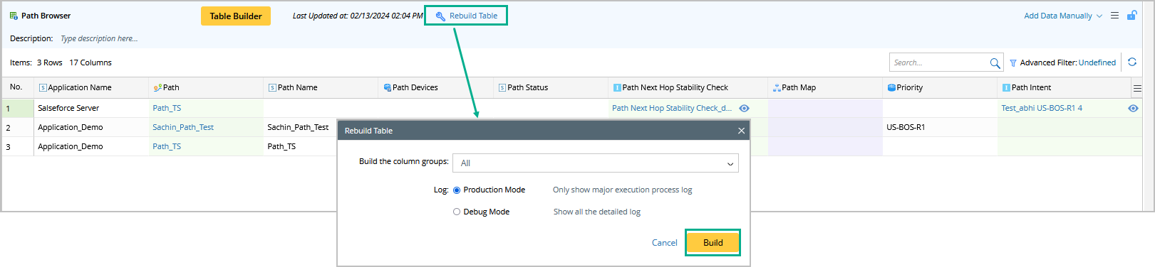

Manually Update Table Data
To increase the flexibility of updating table data, the system provides the capability of manually updating ADT data whenever necessary.
To manually update table data, click Rebuild Table from an open ADT.
By default, all the column data will be rebuilt, however, you can specify some of the columns in ADT for rebuilding table data by configuring Rebuild Table Settings, which will speed the data rebuilding process (for more information, see Select Column Groups for Building/Rebuilding ADT Data).
When you click Rebuild Table, the Build Table dialog appears. You need to define settings as per your preferences. After defining setting, click Build, you will see when the table data rebuilding is in progress. The last time of rebuilding table data (Last Updated at:) is displayed after the process is completed.

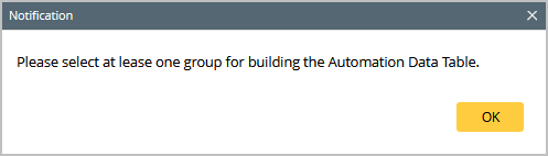

  3. In the Build Table Settings dialog, select column groups for building ADT data. By default, all column groups are selected.
    InformationNote: User must select at least one column group to build ADT data. An error message will prompt the user if no column group is selected.

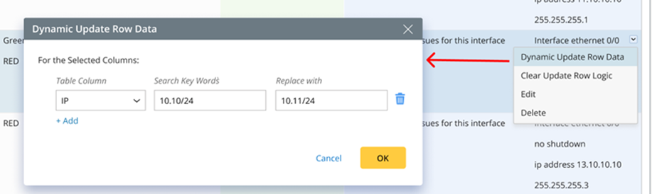

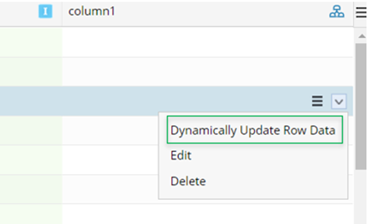

Dynamically Update with Predefined Search-Replace Rules
The data generated from the base table can be dynamically updated by the search-replace rules. You can operate on a target row to change the row data manually.
To update row data manually, follow the steps below:
  1. From the drop-down menu of the target row of the ADT, click Dynamic Update Row Data.
  2. Click + Add, then configure the settings.
  • Table Column: Select a column. The data in the selected table column to be updated.
  • Search Keywords: Type the search keywords to find the original data to be replaced.
  • Replaced with: Type the new data to replace the old data.
               Repeat step 2 to add more data to be updated.
  1. Click OK.
