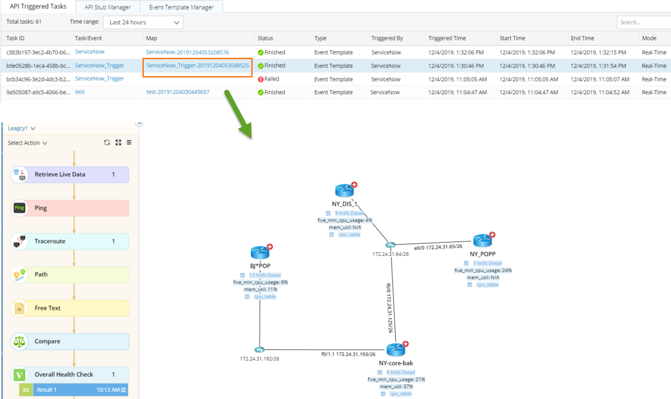

1.Log in to the NetBrain system.
2.Click the start menu
, and select System Automation Manager. The System Automation Task Manager opens on a new page with two tabs displayed. Click the API Triggered Tasks tab. All triggered tasks are listed.
3.Click the map hyperlink of the triggered task to view the created map as well as the data collected by runbook (as long as you have added a runbook when defining the task).
