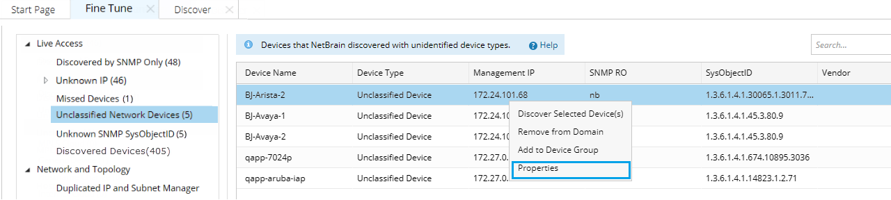

2.In the Domain Management page, click Fine Tune on the Start Page or select Operations > Fine Tune from the quick access toolbar.
3.On the Fine Tune tab, select Unclassified Network Devices in the left pane and all unclassified devices are listed.
1)Copy the sysObjectID for the device.
a)Right-click an unclassified device and select Properties.
b)In the Properties pane, copy the sysObjectID.

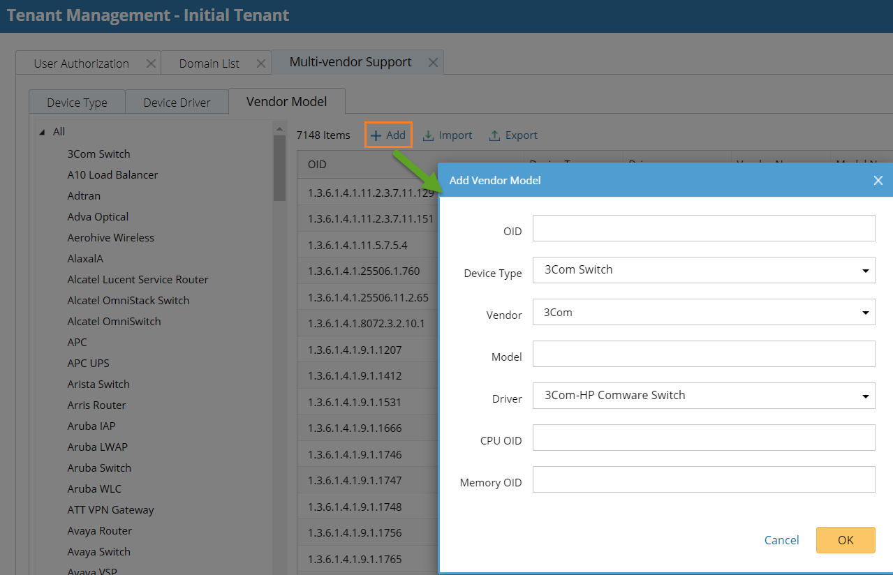

2)Add a device type to the Vendor Model table.
a)Log in to the Tenant Management page.
b)Click Operations > Multi-vendor Support > Vendor Model, and then click Add.
c)In the Add Vendor Model dialog, paste the sysObjectID, select the correct device type and vendor info, and enter the model info.
d)Enter the OIDs in the CPU OID and Memory OID fields. Leave them empty if you don’t have this information currently.
e)Click Add.
3)Repeat step 1) and 2) to add other unclassified devices if these devices have different models (sysObjectIDs).
Tip: If there are several unclassified devices with the same model (sysObjectID), you only need to add one entry to the Vendor Model table.
