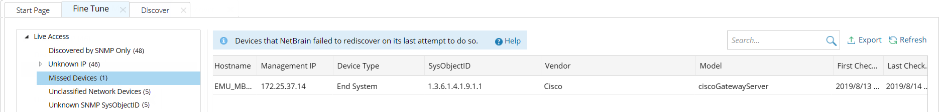

1.Log in to the Domain Management Page.
2.In the Domain Management page, click Fine Tune on the Start Page or select Operations > Fine Tune from the quick access toolbar.
3.In the Fine Tune tab, click Missed Devices in the left pane. All missed devices in the last discovery are listed.
4.Select the devices, right-click them, and select Discover Selected Device(s).
