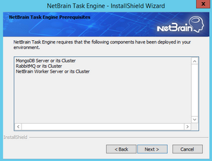

3.Right-click the netbrain-taskengine-windows-x86_64-8.0.3.exe file, and then select Run as administrator to start the Installation Wizard.

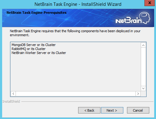

2)On the NetBrain Task Engine Prerequisites page, view the components that must be deployed beforehand in your environment and click Next.

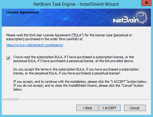

4)On the License Agreement page, read the license agreements, select the I have read the subscription EULA… check box and then click I ACCEPT.

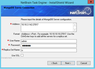

7)On the MongoDB Server Connection page, enter the following information to connect to the MongoDB, and then click Next.
Addressenter the IP address of MongoDB and the corresponding port number. By default, the port number is 27017.
Tip: You can enter the fully qualified domain name (FQDN) of MongoDB if all NetBrain servers are managed in the same domain. For example, test.netbraintech.com:27017.
User Name — enter the username that you created when installing MongoDB.
Password — enter the password that you created when installing MongoDB.
Replica Set Name — enter the replica set name of MongoDB. Keep the default value rs as it is.
Use SSL — used to encrypt the connections to MongoDB with SSL. If SSL is enabled on MongoDB, select this check box; otherwise, leave it unchecked.

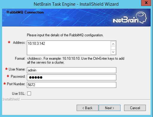

8)On the RabbitMQ Connection page, enter the following information to connect to RabbitMQ, and then click Next.
Address enter the IP address of RabbitMQ.
Tip: You can enter the FQDN of RabbitMQ if all NetBrain servers are managed in the same domain.
User Name enter the admin username that you created when installing RabbitMQ.
Password enter the admin password corresponding to the username that you created when installing RabbitMQ.
Port Numberenter the port number used by RabbitMQ to communicate with Web API Server, Worker Server, and Task Engine. By default, it is 5672.
Use SSL — used to encrypt the connections to RabbitMQ with SSL. If SSL is enabled on RabbitMQ, select it; otherwise, leave it unchecked.

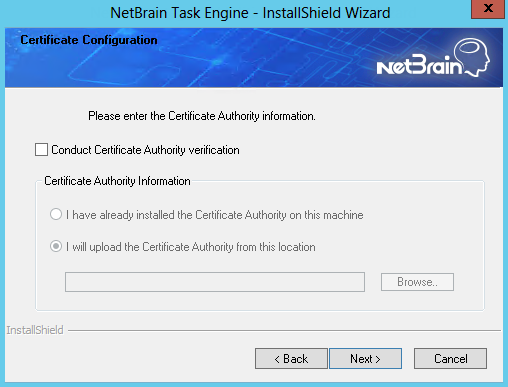

9) (Required only if the Use SSL check box is selected when configuring the connections to MongoDB or RabbitMQ.) On the Certificate Configuration page, configure whether to authenticate the CA of SSL certificates used on MongoDB or RabbitMQ, and then click Next.
To authenticate CA:
a)Select the Conduct Certificate Authority verification check box.
b)If the CA has not been installed on this machine, click Browse to import the CA certificate file, for example, ca.pem; otherwise, select I have already installed the Certificate Authority on this machine.
Note: Only the certificate in Base-64 encoded X.509 PEM format is supported.
Note: The following conditions must be met if you select I have already installed the Certificate Authority on this machine:
- The CA certificate must contain CRL Distribution Points property with valid CRL HTTP distribution point URL. (CRL stands for Certificate Revocation List.)
- The CRL Distribution Points URL must be accessible to Web Server/Worker Server.
- Internet access must be ensured if the certificate is signed by third-party CA.

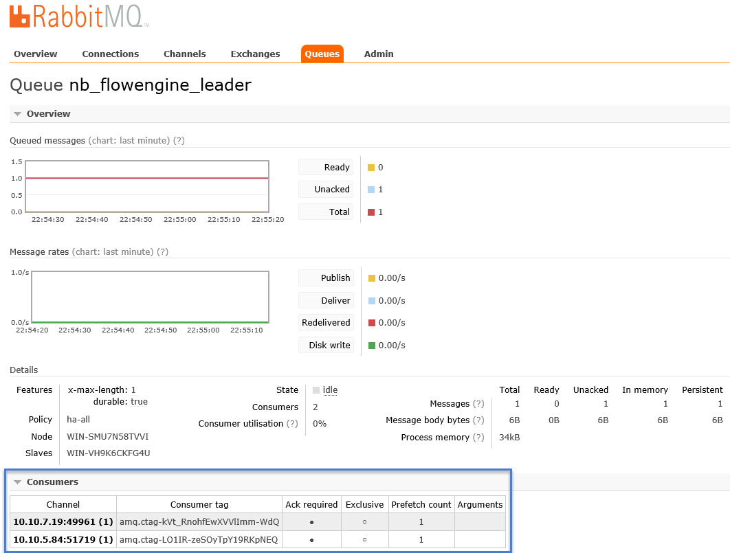

After configuring the cluster, you can log in to the RabbitMQ Management page to browse all cluster nodes.
1.In your web browser, navigate to http(s)://<IP address of RabbitMQ>:port_number. For example, http://10.10.7.171:15672. 15672 is the default port number for the RabbitMQ Management Plugin.
2.Enter the username and password that you created when installing the RabbitMQ, and then click Login.
3.Select Queues > nb_flowengine_leader.
4.Click Consumers. The Task Engine cluster nodes are listed.
The first one is the active node responsible for active operation management. The other one is the standby node.
