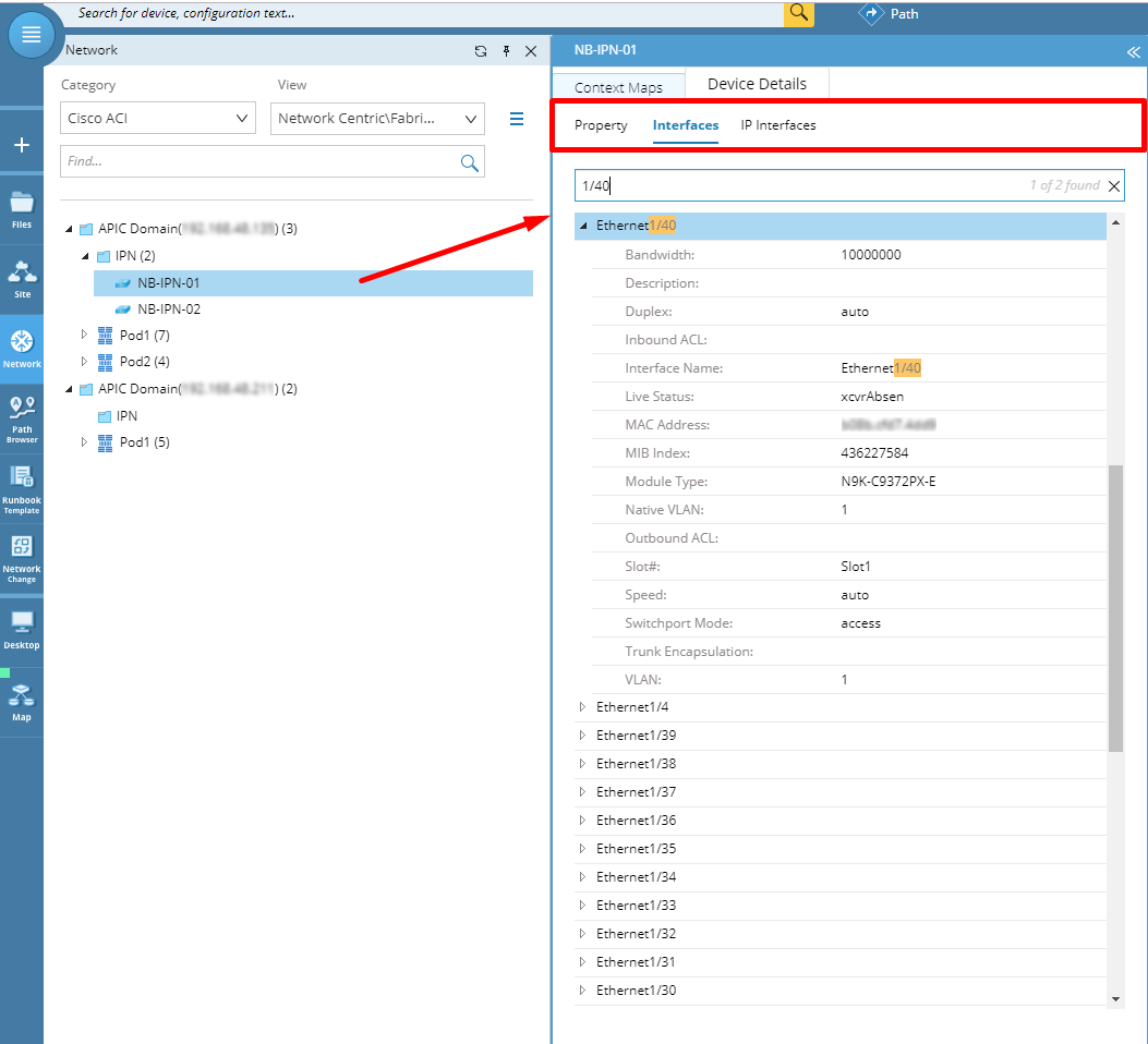

4.Click the IPN node to view all available IPN nodes.
5.Click an IPN node and select the Device Details tab to view more information about the node.
Tip: You can quickly filter the desired information by using a search box on the Interface/IP Interface tab.
