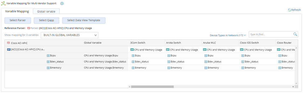

Viewing Variable Mappings
The system provides three ways to initiate the view of variable mappings. In essence, it is to view variable mappings by parsers.
Select Parser
Select Qapp (referencing parsers)
Select Data View Template (referencing parsers)
The view of variable mappings can be toggled between built-in global variables and customized global variables. Built-in variables are predefined and maintained by NetBrain team, and can be saved as customized variables.
Note: The system allows a single parser variable to appear in each category only once at most.
Note: As long as a parser variable belongs to the customized category, the system will only look up variable mappings in the customized category; if a parser variable only belongs to the built-in category, the system will only look up variable mappings in the built-in category.
