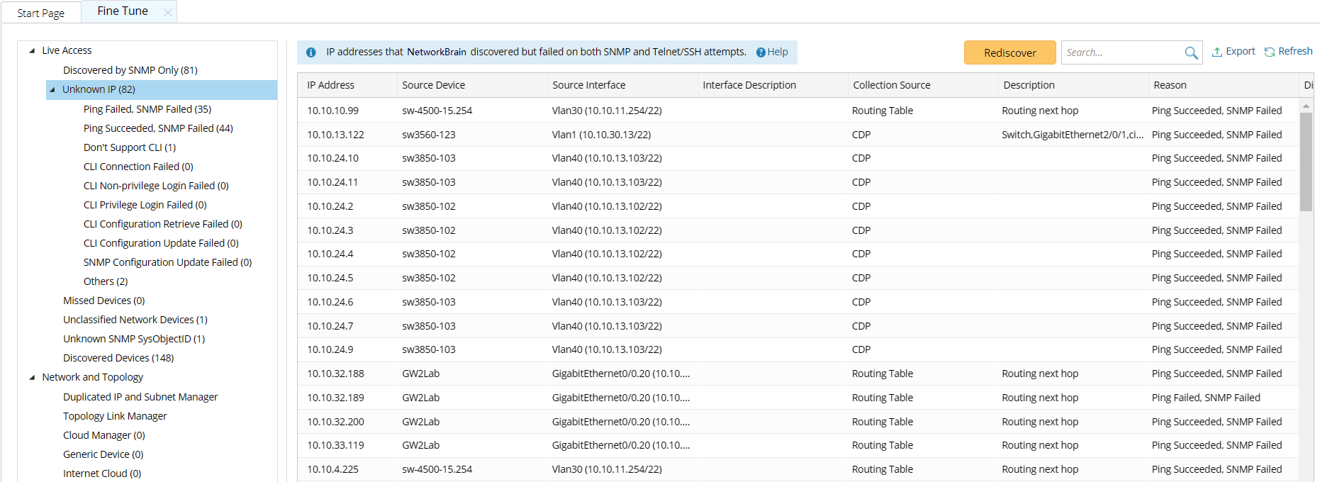

Unknown IP refers to the IP addresses of the devices that are discovered from seed routers but cannot be accessed by using Telnet/SSH or SNMP.
The table lists the Unknown IP reasons and their solutions depending on the possible causes. Contact NetBrain Support Team for further assistance.
