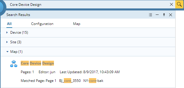

1.Enter one of the following search terms in the search bar:
Map name
Map page name
Device hostname or management IP address
Interface name or IP address
Map note
2.Click the icon or press the Enter key on your keyboard to start searching. The search results are displayed with the matched keyword highlighted.

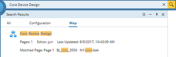

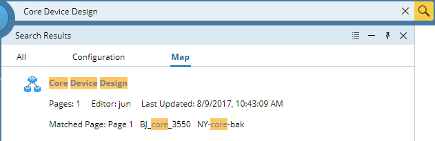

3.Select the Map tab to narrow down the search results.
4.Point to a map result and then click the icon to preview the map.
Tip: To open the map directly, point to a map result and then click the icon to select Open.
Tip: To share the map, point to the map entry and click the icon to select Share. See Sharing a Map for more details.
