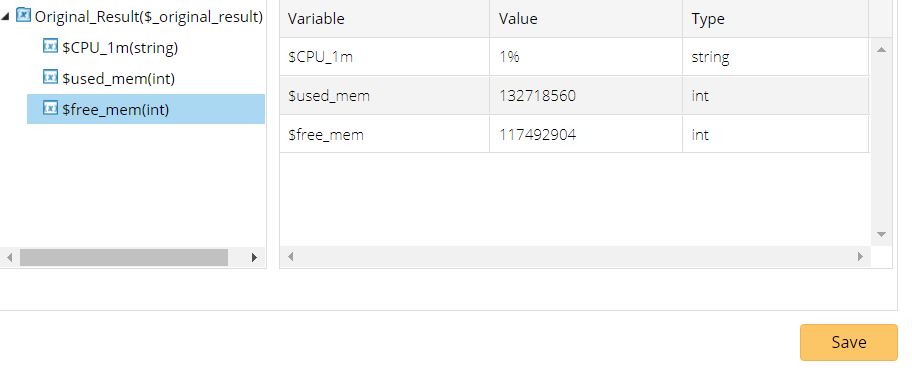

▪Variable — the variable defined in the parser. To change the auto-created variable name to a more meaningful name, rename the variable such as from var1 to CPU_1m.
3)Click Save Variable in the Keyword Parser dialog. This variable will be displayed in the variable tree.
4)Follow the above steps to add the variable of the five-minute CPU utilization.
7.Parse the memory utilization.
1)Highlight the used memory value 15225656 in the sample data (do not include the spaces before and after the metric), and then click Define Keyword in the floating menu.
2)The Keyword Parser dialog prompts with the Parser field (Used: $int:var1 Free:) auto-identified.
3)Rename the var1 to used_mem in the Variable field.
4)Click Save Variable in the Keyword Parser dialog.
5)Follow the above steps to add the variable of the free memory space. Then both the CPU and memory utilization are displayed in the variable tree.
8.Click Save. The parser will be saved in the Parser Library.

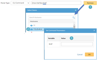

Note: The command input supports the commands with variables. You need to set values for the variables when you retrieve data.
