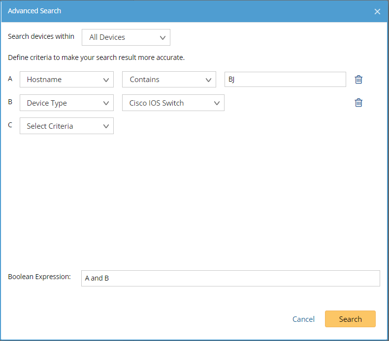

Advanced search allows you to build complex search queries to search for devices by using multiple search criteria and a boolean expression.
Using Advanced Search
1.Click the search bar and then select Advanced Search from the drop-down list.
2.Specify the scope to search for devices.
3.Set search criteria A based on your needs:
1)Select a data source and a property from the first drop-down menu.
2)Select an operator from the second drop-down menu.
3)Specify the value of the property that you selected.
4)Repeat to set more conditions if required.
4.Define the condition combination in the Boolean Expression field. For example, A and B.

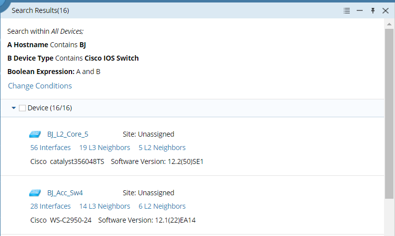

6.Click Search. The searched result is displayed as follows:
Components for Advanced Search
