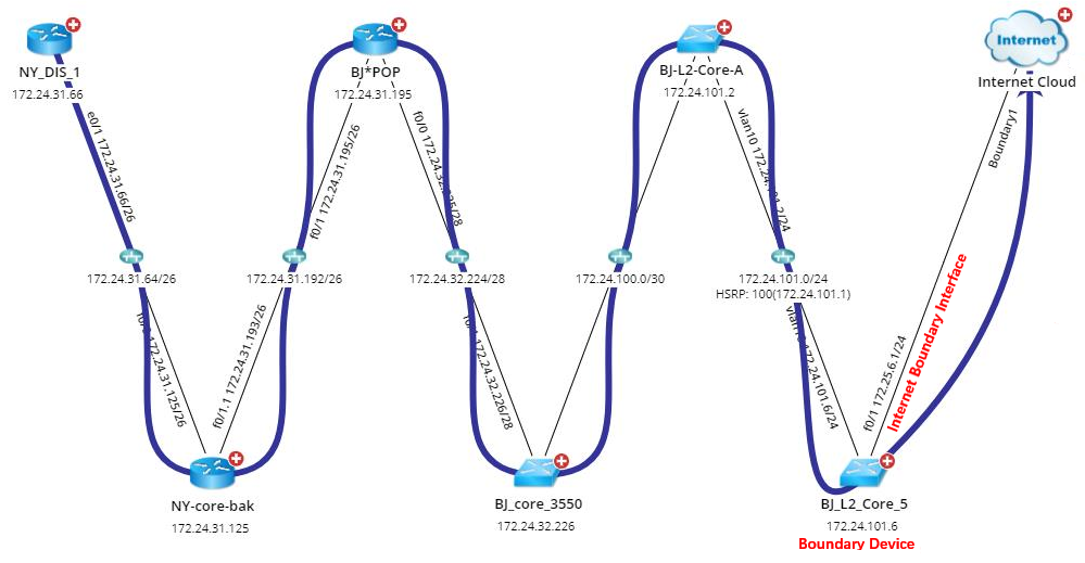

Internet Cloud refers to the Internet that the boundary device connects to. In general, an Internet Cloud is regarded as a device, and it will be assigned an interface randomly. With the Internet Cloud, you can view the path between the Internet and the boundary device on a map.
Here is an example of a path through the Internet.
