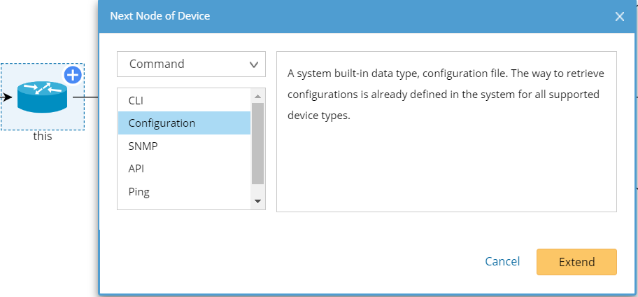

5.Extend a Configuration command node from the Device(this) node.
Note: Compared to the CLI Command node that retrieves live data by sending CLI command to devices, the Configuration node uses baseline configuration of devices in your domain.
