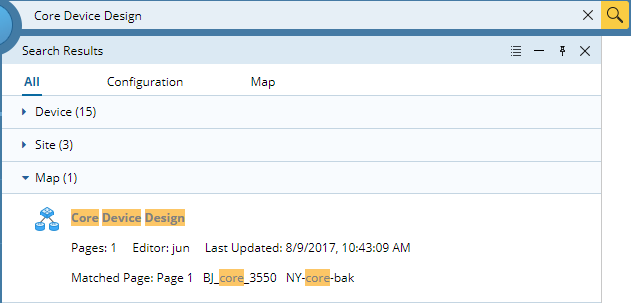

2.Click the
icon or press the Enter key on your keyboard to start searching. The search results will be displayed in the lower pane with the matched keyword highlighted.

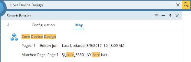

3.Select the Map tab to narrow down the search results.
