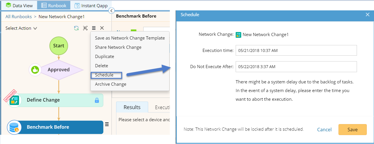

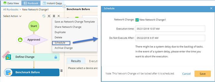

You can set a scheduled time point for a change management task. Then all actions will be executed automatically and sequentially when it reaches the time point.
1.Open the target change management task, and click the
icon to select Schedule.
2.In the Schedule dialog, select the time point to execute the change:
▪Execution Time — the time to start the task.
▪Do not Execute After — the time to drop the task if it does not start before the time.
