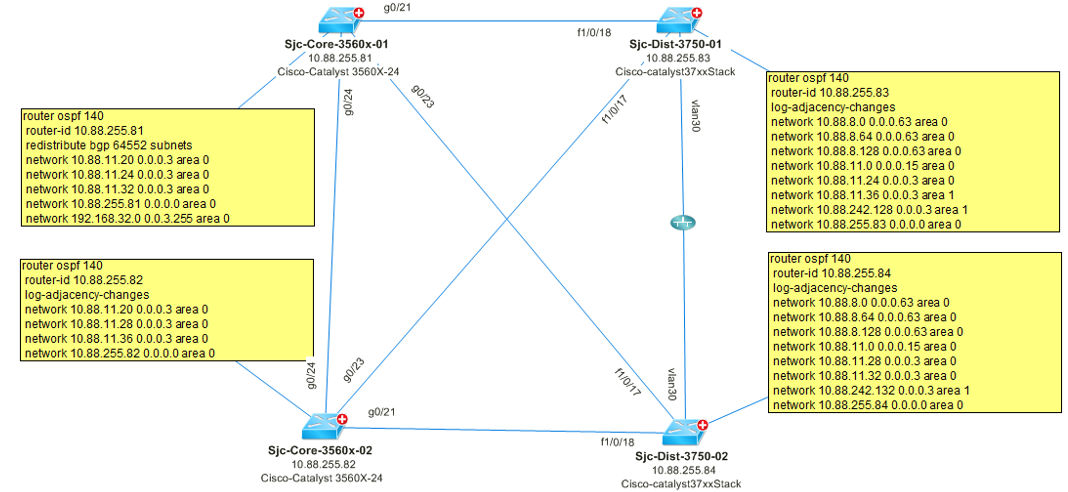

Defining Output to Highlight Devices with OSPF Configuration
1.Extend a Basic Output node after the Table node. In the Output node, define a condition to check whether the ospf_config variable exists:
If $ospf_config is not None    (meaning that the OSPF configuration exists)
2.Extend a Highlight Map action node from the Output node, and define it as follows:
1)Select the Highlight Device check box.
2)Select $_device from the drop-down menu of the Device field. The $_device variable refers to the devices you will draw on the map.
3)In the Legend field, type a legend content. For example, enter "OSPF Config".
3.Extent a Draw Note action node from the Highlight Map node.
1)Select the Device Note check box.
2)Select $_device from the drop-down menu of the Device field. The $_device variable refers to the devices you will draw note on.
3)In the Title field, type a legend content. For example, enter "OSPF Config".
4)In the Content field, enter $ and select $ospf_config from the pop-up list.
4.Save and run the Qapp.
