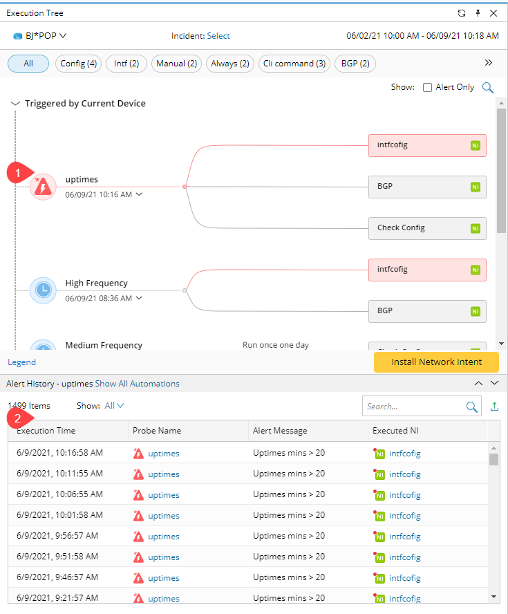

The lower side of the execution tree displays the alerts generated during the selected time range.
Note: The alerts generated by probes and network intents are sorted by the Execution Time.
Note: When a network intent is shown in the same row as a flash probe, it indicates that the network intent is triggered by this flash probe.
Click the interested probe or network intent on Execution Tree, the respective alert history will be displayed.

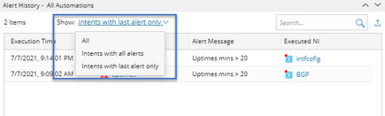

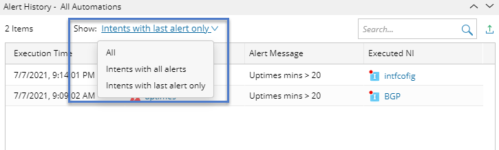

Use the drop-down filter to narrow down to the interested alerts:
oIntents with all Alerts: To view the intent alerts generated for the current device.
oIntents with last alert only: To view the latest intent alert for each intent.
