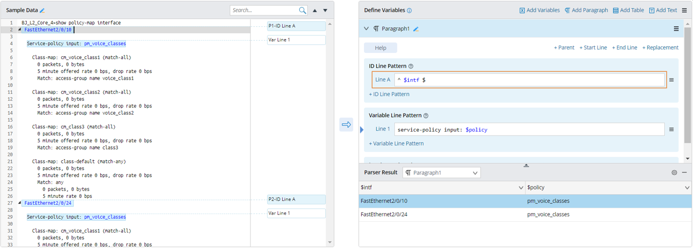

Using Special Character for Exact Match
Take the following paragraph parser for example: the parent line only contains a variable of interface name (note that there is space before and after the variable). To define the parent line pattern, you can use “^ $intf $”, which means the variable starts with a space and ends with a space.

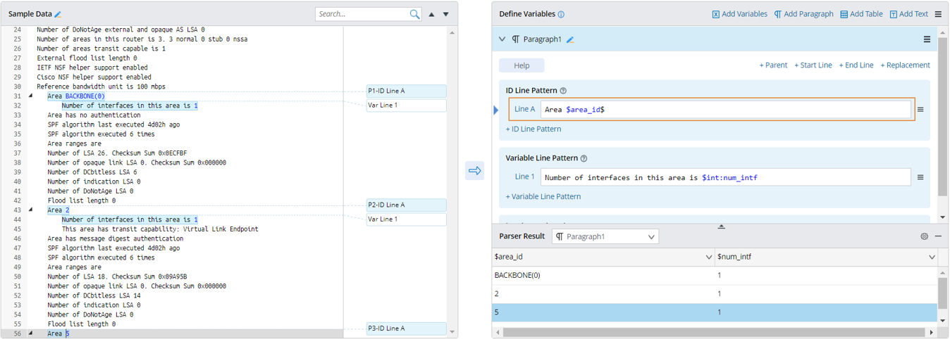

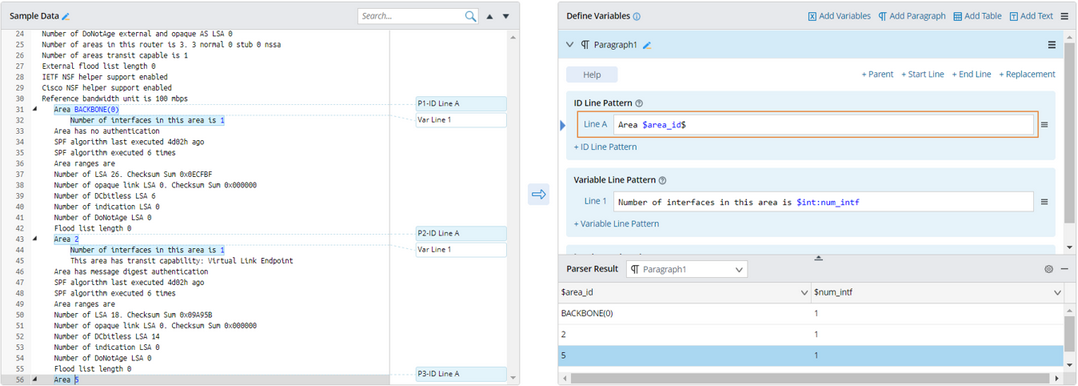

Using Special Character to Avoid Mismatch
Take the following paragraph parser for example, there are multiple lines starting with the keyword “Area”. To only parse the variable of Area ID, you can use “Area $area_id$” in the ID line pattern, so that only the lines that end with an Area ID will be parsed as ID line.
