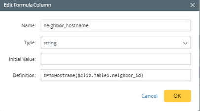

3.Define the Name, Type, and Definition for the Formula Column. It is optional to set an initial value for Formula Column.
Name — Name can only contain letters, numbers, and underlines, and can only start with a letter or underline.
Type — The selection of the Type should be set according to the data type actually returned by compound variable or formula.
Definition — The Definition input supports two ways, one is mathematical operation, such as $var1 + $var2; the other is to call functions and see Appendix: Supported Functions in Network Intent for list of supported functions in Network Intent.

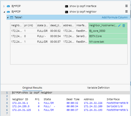

4.Click OK and the Formula Column is added as a new column to the table and marked with green color.
