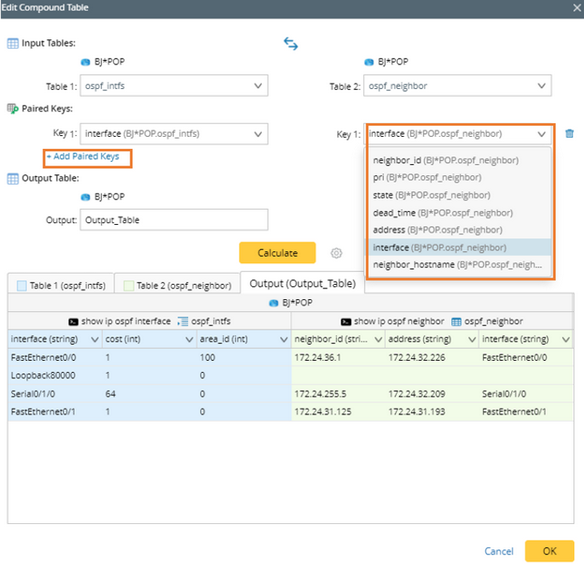

3.In the pop-up window, open the drop-down menu to select the table variables for Table 1 and Table 2.
4.Click Add Paired Keys to define the Paired Keys for Table 1 and Table 2. The Paired Keys defines the column pairs to be merged and you can have multiple Paired Keys.

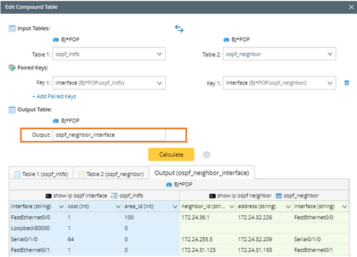

5.Define the name for output table.

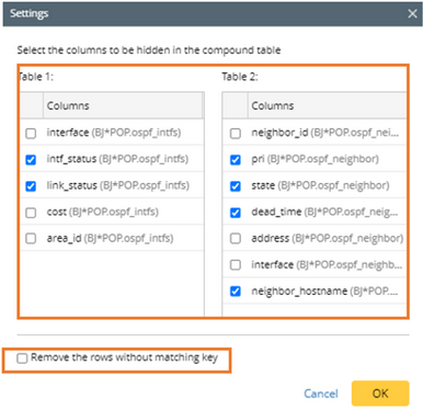

6.Click the icon to hide certain rows or remove the rows without matching keys in compound table.

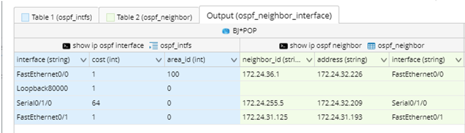

7.The columns in the output table are marked with different colors to distinguish the columns from Table 1 and Table 2.
