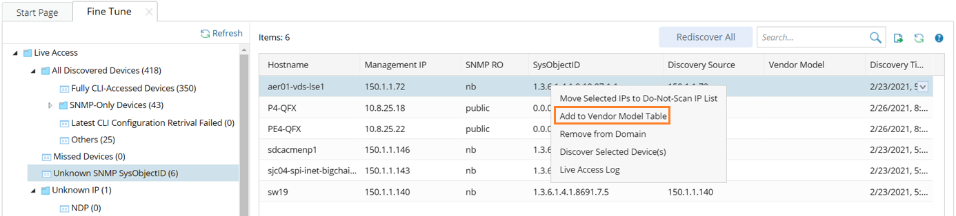

2.In the Domain Management page, click Fine Tune on the Start Page or select Fine Tune from the start menu.
3.In the Fine Tune tab, select Unknown SNMP sysObjectID in the left pane. The devices with unknown SNMP sysObjectIDs are listed.
4.Add the unknown SNMP sysObjectIDs to the Vendor Model table one by one.
1)Right-click a device, select Add to Vendor Model Table from the drop-down menu.
2)In the Add Vendor Model dialog, configure the vendor and model information.
