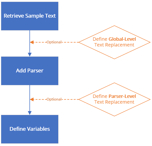

Text replacement can be defined in two levels:
▪Global level: search and replace a string in the whole range of sample text.
▪Parser level: search and replace a string in the given range of text that has been matched by a specific parser’s definition.

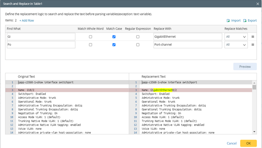

Use Cases of Text Replacement
▪Form a Table Header Line
When a device command output looks very similar to a standard table format but only misses a table header line, you can define text replacement to replace the line of text ahead of the table data with a customized table header line. This twist allows you to continue to define a table parser to parse the table data.
▪Fill Up Table Headers
When one or more table headers are missing in the sample text, using a table parser directly will lose the data of those columns.
▪Rename Duplicate Table Header
When there are two table headers with a duplicate name, the latter one cannot be parsed. The workaround is to rename table headers so that each header can have a unique name. This can be done by replacing the line of table headers with a new one.
▪Adjust table column width
Sometimes the table headers are not aligned with data cells and cannot be parsed by a table parser. For example, the alignment gap between table headers and cells causes an incorrect parsed result.
▪Translate Interface Name
Sometimes interface names in the raw text are irregular and cannot be further used before manual processing.
