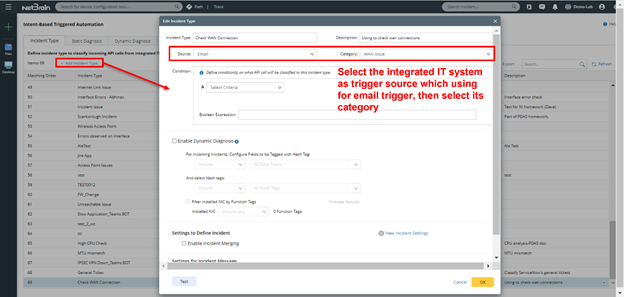

5. Define the Incident Type
For Triggered Diagnosis by Email, the Source of the Incident Type must be Email.
After the Incident Type is defined, you can export the Email template.
