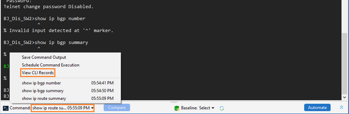

1.Click the Command area, then click View CLI Records to display all the executed commands.

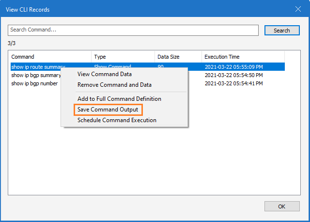

2.In the View CLI Records dialog, right-click the target command and click Save Command Output.

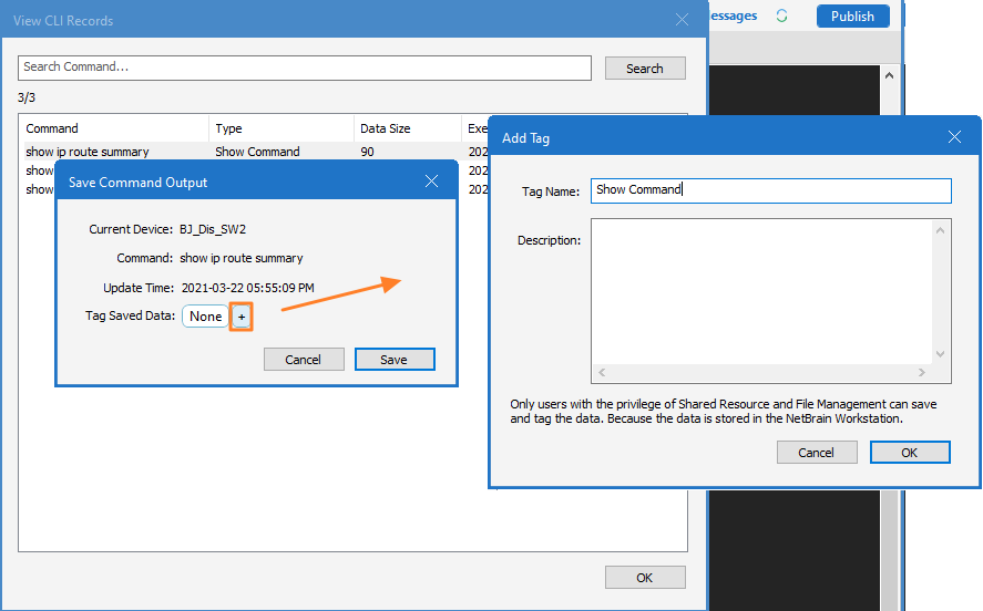

3.In the Save Command Output dialog, tag the saved data to quickly find it for use in future. Click OK.
4.Click Save.
