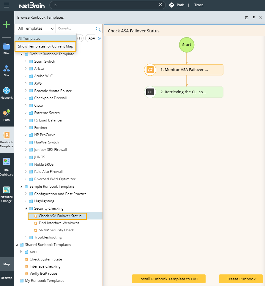

1.On a map with Cisco ASA firewalls, click Runbook Template on the taskbar.
2.In the runbook template tree, select Security Checking > Check ASA Failover Status, and click Create Runbook.
Tip: You can select Show Templates for Current Map check box to filter runbooks based on device types included on the map.

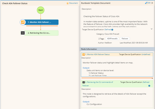

Tip: You can also click a node to preview it using document with corresponding information highlighted.

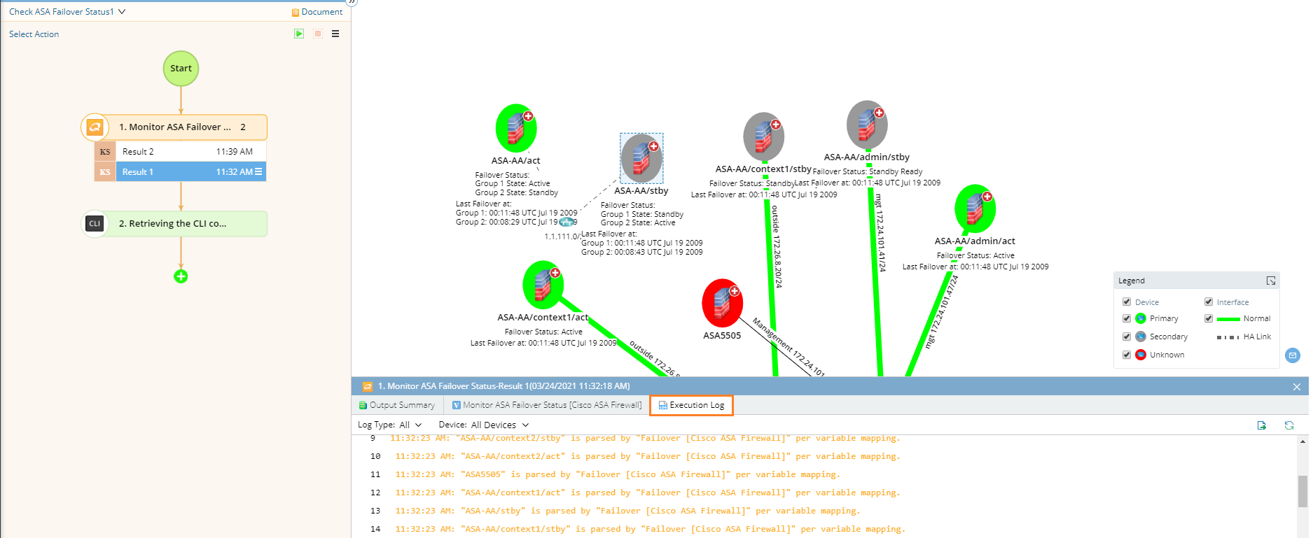

3.In the Monitor ASA Failover Status Qapp node, add target devices, select Pull live data once in the Data Source area and click Run. The active and standby status of ASA firewalls is displayed on the map. According to the legend, the ASA-AA/act firewall is secondary and the ASA-AA/stby firewall is primary. You can click Execution Log to view the detailed log regarding how the Qapp retrieves data from target devices.

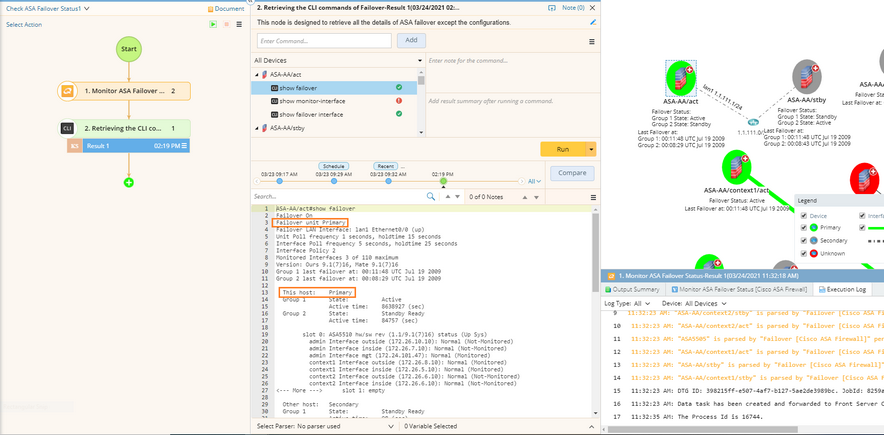

4.In the Retrieving CLI commands node, click Run. From the output result, the status issue is verified.

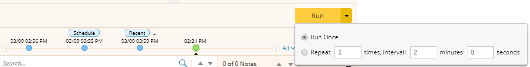

Note: You can set the frequency to recur the execution repeatedly. By default, the Run Once is selected.
Tip: After you make the settings for all nodes, click the icon to run all nodes, and click the icon to stop all nodes.

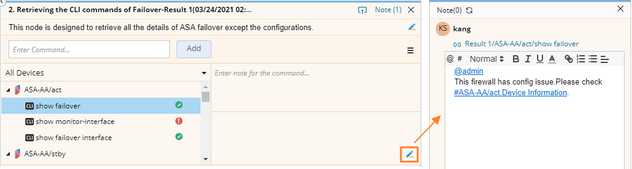

5.(Optional) Click the pencil icon to add notes to mention other users to further check configurations.
