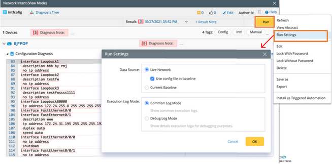

1.In the Network Intent (View Mode) window, Click the icon and select Run Settings.
2.Select Live Network or Current Baseline as the data source and click OK.
3.Click Run to execute the Network Intent.

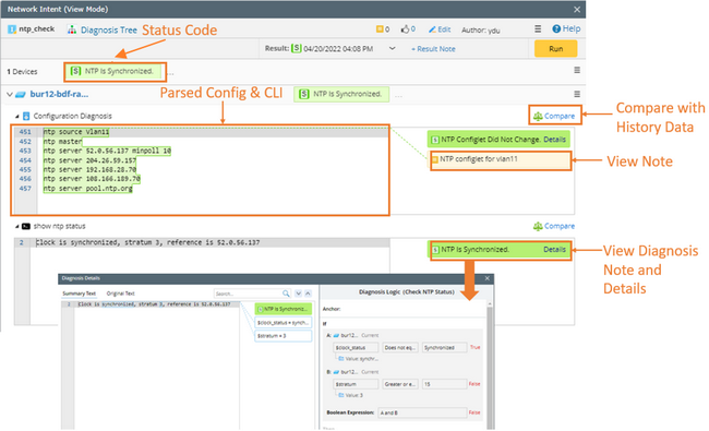

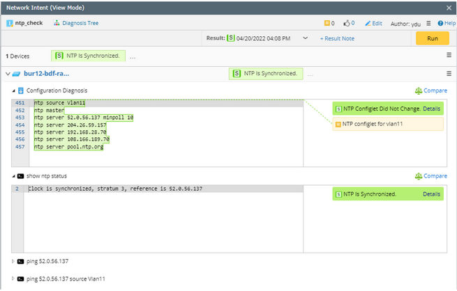

4.In the NI result window, review the execution time, the alerts, if any, and the variables displayed.
Example: The main information of NI result in NI detail pane.
