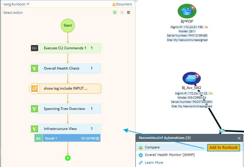

Three ways of the device qualifications defined in the template will be automatically applied to refine target devices on the current map:

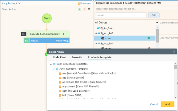

▪When you create a runbook on a map by applying a runbook template:
▪When you add the runbook template in the runbook:
▪Add runbook template to a runbook in the recommended automation with the data view template, decision tree, and network intent:
