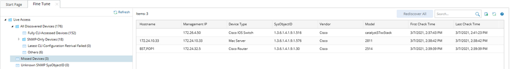

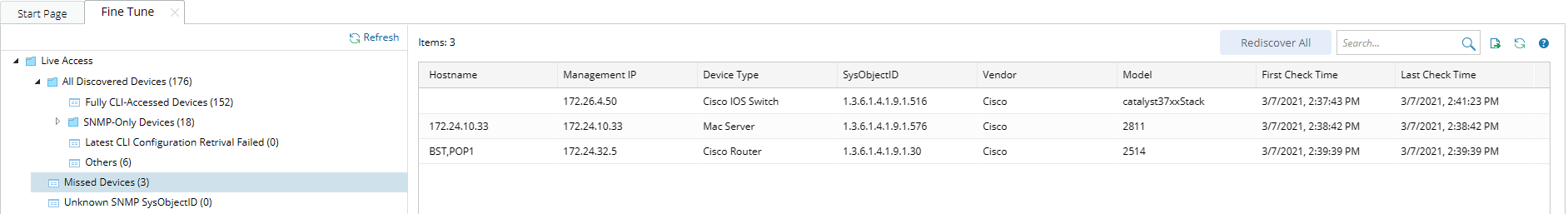

2.In the Domain Management page, click Fine Tune on the Start Page or select Fine Tune from the start menu.
3.In the Fine Tune tab, click Missed Devices in the left pane. All missed devices are listed.

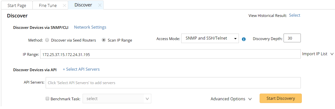

4.Select the devices, right-click them, and select Discover Selected Device(s).
5.On the Discover tab, rediscover the decommissioned devices to verify whether they can be discovered.
1)Select Scan IP Range to only discover the specified IPs.
2)Select one access method according to the configuration on your devices.
3)Click Network Settings to specify the proxies and credentials to be used in the discovery or keep it as default.
4)Click Start Discovery.
If these devices are rediscovered successfully, they can be automatically moved from the Missed Devices category to the Fully Accessed via CLI category. Otherwise, you can manually remove them from your domain by right-clicking them and selecting Remove from Domain from the drop-down menu.
