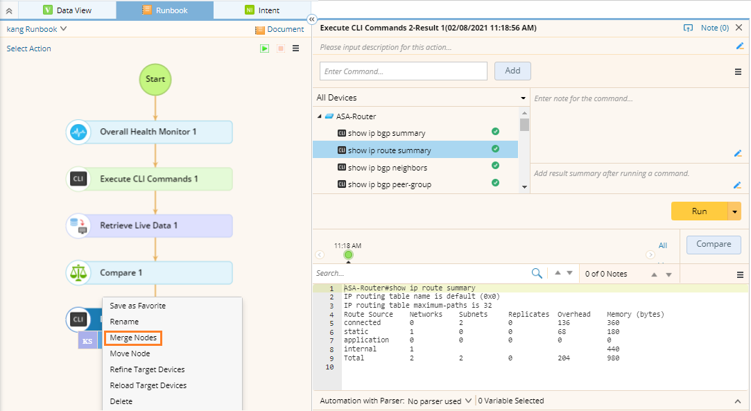

1.Select the target action node that you want to use as the final node to merge other action nodes of the same type in the runbook, and then click the icon to select Merge Nodes.
2.Select the corresponding check box to include the desired actions in the same type. Click Merge.
3.Click the target action node to browse all the execution results.
