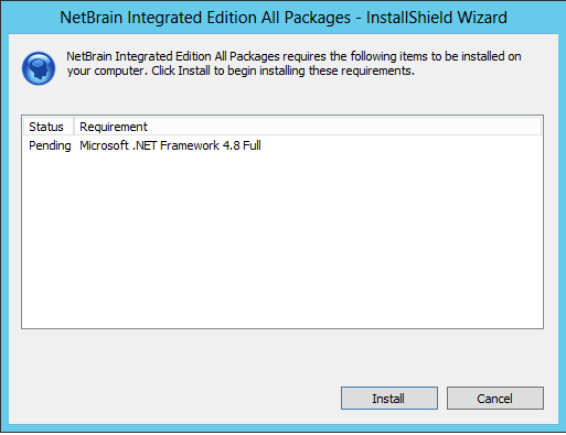

1).NET Framework 4.8 must be pre-installed on this machine before you install the Application Server. The Installation Wizard will automatically check this dependency. If it has not been installed, the wizard will guide you through the installation as follows; it has been installed, the wizard will directly go to step 2).
Note: Make sure the Windows update is of the latest. For Windows Server 2012, you might be asked to install some software patches before the .NET Framework 4.8 installation can start.
a)Click Install.

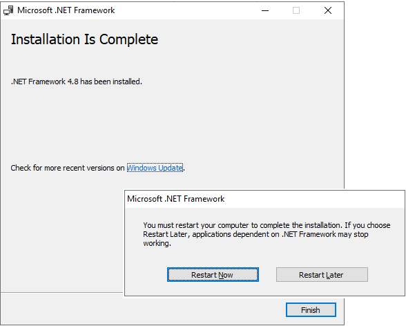

b)Read the license agreement of Microsoft .NET Framework 4.8, select the I agree to the license terms and conditions check box and click Install. It might take a few minutes for the installation to be completed.
Note: Some running applications must be closed during the installation of .NET Framework 4.8, such as Server Manager.
c)You must click Restart Now to restart the machine immediately. Otherwise, the upgrade will fail due to the failure of upgrading the new .Net Framework. After the machine reboots, continue with step 2).
Note: The interface above may not appear if the .NET Framework has never been installed on the server. In such case, it is still highly recommended to reboot the server after the installation of the .NET Framework completes.

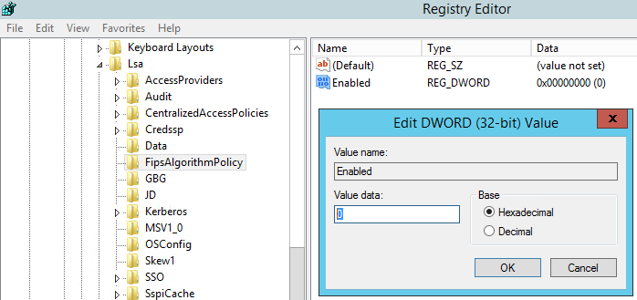

Note: Ensure the FIPS is disabled after restarting the machine. To disable the FIPS setting, modify the Enabled value to 0 under the HKEY_LOCAL_MACHINE\SYSTEM\CurrentControlSet\Control\Lsa\FipsAlgorithmPolicy directory of Windows registry

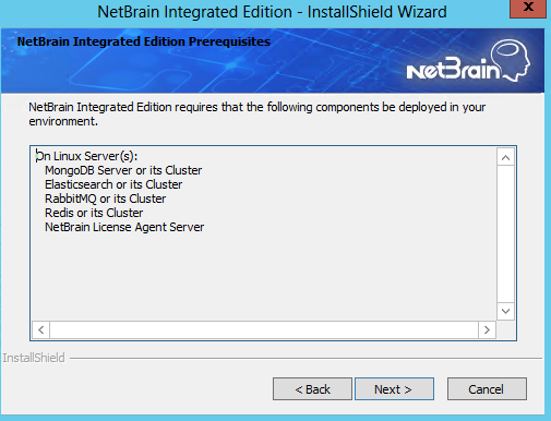

3)On the NetBrain Integrated Edition Prerequisites page, read the components that must be set up in your environment beforehand and click Next.

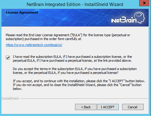

5)On the License Agreement page, read the license agreements, select the I have read the subscription EULA… check box and then click I ACCEPT.

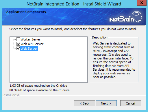

8)Select both the Web API Service and Web Server check boxes, and then click Next.

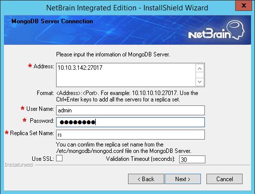

9)On the MongoDB Server Connection page, enter the following information to connect to MongoDB and then click Next.
Addressenter the IP address or resolvable FQDN of MongoDB and the corresponding port number. By default, the port number is 27017.
Tip: You can enter the fully qualified domain name (FQDN) of MongoDB if all NetBrain servers are managed in the same domain. For example, test.netbraintech.com:27017.
User Name — enter the username that you created when installing MongoDB.
Password — enter the password that you created when installing MongoDB.
Replica Set Name — enter the replica set name of MongoDB. Keep the default value rs as it is unless you changed it.
Use SSL — used to encrypt the connections to MongoDB with SSL. If SSL is enabled on MongoDB, select this check box; otherwise, leave it unchecked.
Validation Timeout (seconds) — it is used to set the connection timeout threshold (in second) to validate the connection to the dependent server. This will not affect the application running timeout value.

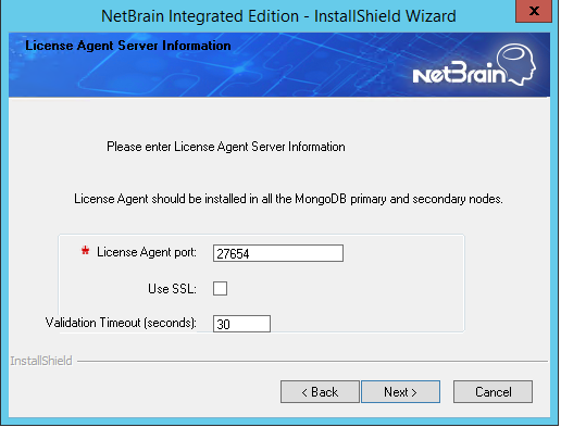

10) On the License Agent Server Information page, enter the following information to connect to License Agent, and then click Next.
License Agent port — the port number that the service of License Agent Server listens to. By default, it is 27654.
Use SSL — used to encrypt the connections to License Agent Server with SSL. If SSL is enabled on License Agent Server, select it; otherwise, leave it unchecked.

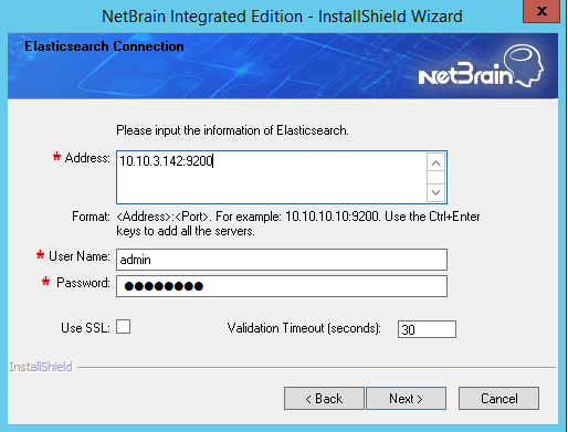

11) On the Elasticsearch Connection page, enter the following information to connect to Elasticsearch, and then click Next.
Addressenter the IP address or resolvable FQDN of Elasticsearch and the corresponding port number. For example, 10.10.3.142:9200.
Note: If a proxy server is configured on this machine to access the Internet, you must add the IP address and port number of Elasticsearch into the proxy exception list of the web browser, to ensure this NetBrain server can communicate with Elasticsearch.
Tip: You can enter the FQDN of Elasticsearch if all NetBrain servers are managed in the same domain. For example, test.netbraintech.com:9200.
User Name — enter the username that you created when installing Elasticsearch.
Password — enter the password that you created when installing Elasticsearch.
Use SSL — used to encrypt the connections to Elasticsearch with SSL. If SSL is enabled on Elasticsearch, select it; otherwise, leave it unchecked.

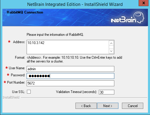

12) On the RabbitMQ Connection page, enter the following information to connect to RabbitMQ, and then click Next.
Address enter the IP address or resolvable FQDN of RabbitMQ.
Tip: You can enter the FQDN of RabbitMQ if all NetBrain servers are managed in the same domain.
User Name enter the admin username that you created when installing RabbitMQ.
Password enter the admin password corresponding to the username that you created when installing RabbitMQ.
Port Numberenter the port number used by RabbitMQ to communicate with Web API Server, Worker Server, and Task Engine. By default, it is 5672.
Use SSL — used to encrypt the connections to RabbitMQ with SSL. If SSL is enabled on RabbitMQ, select it; otherwise, leave it unchecked.

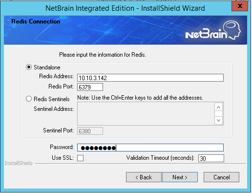

13) On the Redis Connection page. enter the following information to connect to Redis by selecting the Standalone mode, and then click Next.
Redis Address — enter the IP address of Redis.
Tip: You can enter the FQDN of Redis if all NetBrain servers are managed in the same domain.
Passwordenter the admin password that you created when installing Redis.
Use SSL — used to encrypt the connections to Redis with SSL. If SSL is enabled on Redis, select it; otherwise, leave it unchecked.
Redis Portenter the port number used by Redis to communicate with Web API Server, Worker Server, and Front Server Controller. By default, it is 6379.

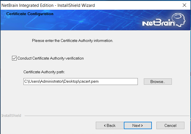

14) (Required only if the Use SSL check box is selected when configuring the connections to MongoDB, License Agent, Elasticsearch, RabbitMQ, or Redis.) Configure whether to authenticate the Certificate Authority (CA) of the SSL certificates used on these servers, and then click Next.
To authenticate CA:
a)Select the Conduct Certificate Authority verification check box.
b)If the CA has not been installed on this machine, click Browse to import the CA certificate file, for example, ca.pem.
Note: Only the certificate in Base-64 encoded X.509 PEM format is supported.
Note: The following conditions must be met for the CA certificate file:
- The CA certificate must contain CRL Distribution Points property with valid CRL HTTP distribution point URL. (CRL stands for Certificate Revocation List.)
- The CRL Distribution Points URL must be accessible to Web Server/Worker Server.
- Internet access must be ensured if the certificate is signed by third-party CA.

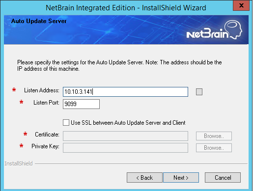

17) On the Auto Update Server page, configure the listen address and listen port.
Use SSL between Auto Update Server and Client — used to encrypt the connections between Auto Update Server and Client with SSL. Otherwise, leave it unchecked.
oCerticate — required only if Use SSL... is selected. Click Browse to select the certificate file containing the public key. For example, cert.pem.
oPrivate Key — required only if Use SSL... is selected. Click Browse to select the private key file. For example, key.pem.
Note: The Listen Address must be the local server’s IP address which can be reached from other NetBrain servers including Front Server.
