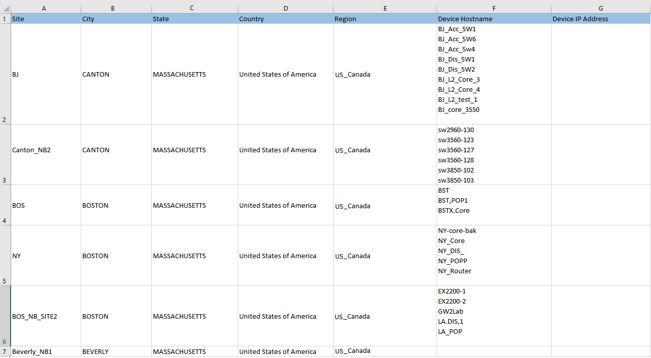

1.Prepare a spreadsheet with the table headers organized as follows to set the site hierarchy. Here is an example:
Site Name (Office)\City\State\Country\Region\Device Hostname
Note: Only the .csv, .xls, and .xlsx formats are supported. You can add more column headers or leave some columns blank based on your network distribution.
Note: The site name cannot contain any special characters, such as \ / : * ? " < > | . $
Note: The values in the Device Hostname column must be the same as those in the domain so that the devices can be identified and added to the corresponding leaf sites.
Note: The value in the Device IP Address column will be set as the criteria to search for site members. Only one IP address is supported in each row. You can leave it blank if not required.

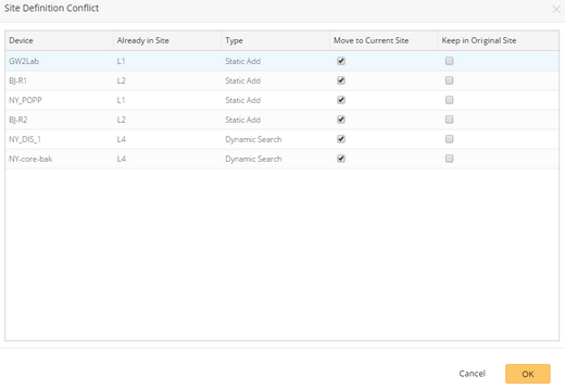

Tip: A device only can belong to one leaf site. When you add a device that has already been assigned to one site, a site definition conflict will occur. Click OK to move the device to the current site. To keep it in its original site, select the Keep in Original Site check box.

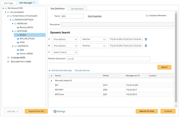

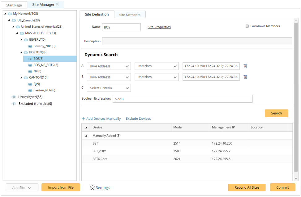

6.Click OK. The site nodes are created in the site tree. You can further add more devices to leaf sites. See Adding Devices into Leaf Sites for more details.
7.Click Rebuild All Sites to rebuild the site topology. The Site Members tab opens automatically, listing the device members in the currently selected site.
