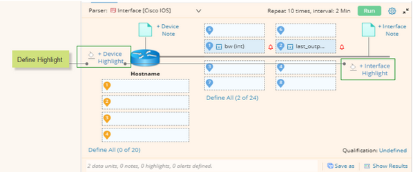

The entrances of highlight definition:

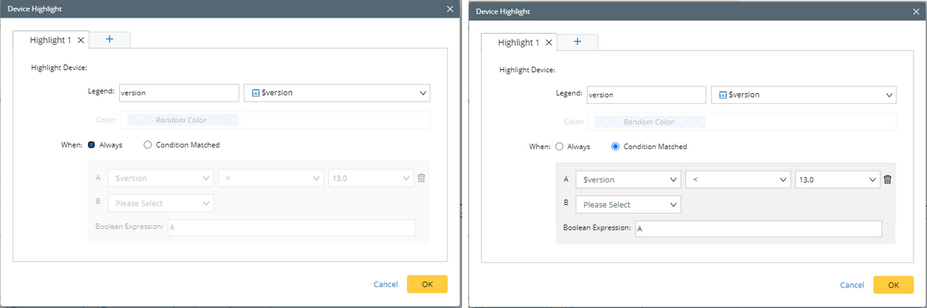

Highlight Device:
                                                                         Always                                                                                                                When Condition Matched

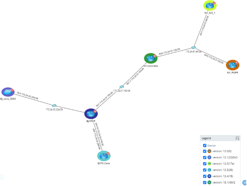

With the above device highlight definition, the devices shown on the map will be highlighted if the specified condition matched:

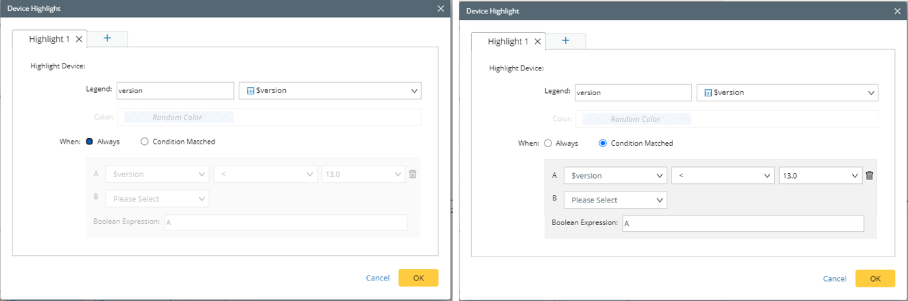

Highlight Interface:

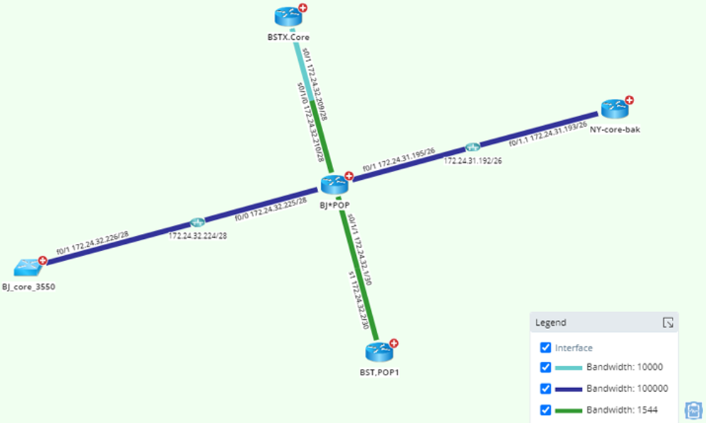

With the above interface highlight definition, the interfaces shown on the map will be highlighted if the specified condition is matched.
