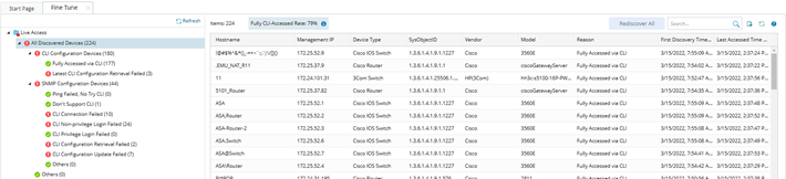

2.In the Domain Management page, click Fine Tune on the Start Page or select Fine Tune from the start menu.
3.In the Fine Tune tab, click All Discovered Devices in the left pane. All discovered devices are listed.
4.Based on how NetBrain retrieved the config files, devices are assigned to 3 categories: Configuration Devices, SNMP Configuration Devices and Others.
•CLI Configuration Devices: Fully accessed via CLI indicates that NetBrain successfully retrieved the config files via the latest CLI attempt; Latest CLI Configuration Retrieval Failed indicates that NetBrain failed to retrieve the config files via the latest CLI attempt.
•SNMP Configuration Devices: Those devices are categorized carefully by the reasons why NetBrain can only retrieve SNMP configurations.
•Others: Devices that NetBrain failed to distinguish if they are accessed by CLI or SNMP.
