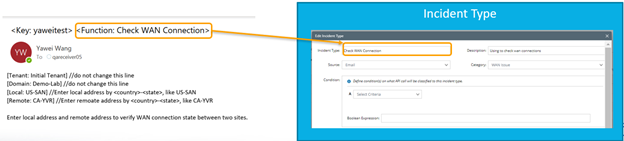

3. The IE system matches the email with the Incident Type.
The system will match the email with the Incident Type using the Incident Type specified in the Email Subject. The words after 'Function: 'must be the same as the name of the matched Incident Type.
For this example, the Check WAN Connection in the Email Subject matches the Incident Type Check WAN Connection and so the Incident Type Check WAN Connection is matched with the email.

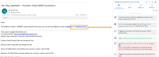

5. IE system executes the diagnosis and replies the results to the end-users.
After the Diagnosis is executed, NetBrain will send the you the link to the Incident Portal. By clicking on the link, you can view the detailed execution result in the IE system.
