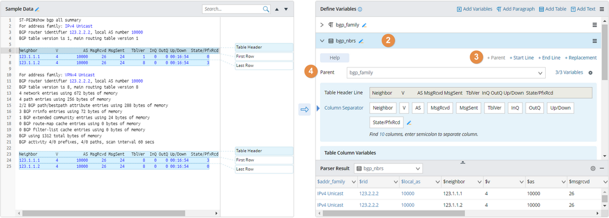

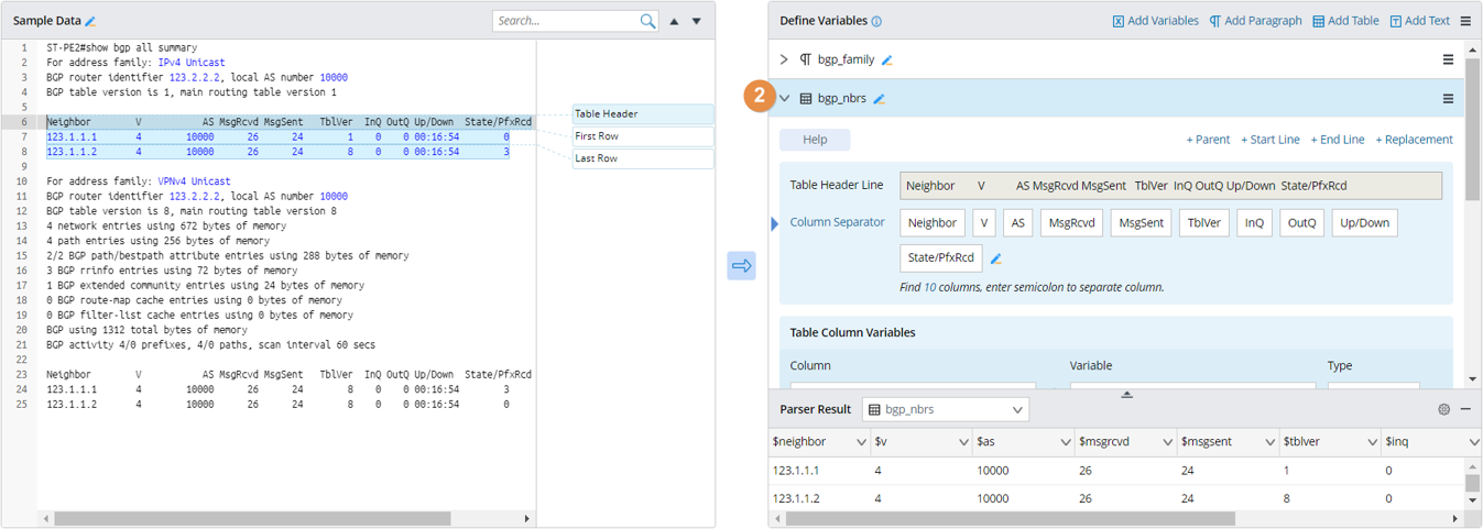

Example2: Create parser for nested table for command show bgp all summary.
1.Define parent paragraph bgp_family.
2.Define table bgp_nbrs.
3.Click Add Parent to add parent paragraph.
4.Select paragraph bgp_family as parent paragraph from the drop-down menu.

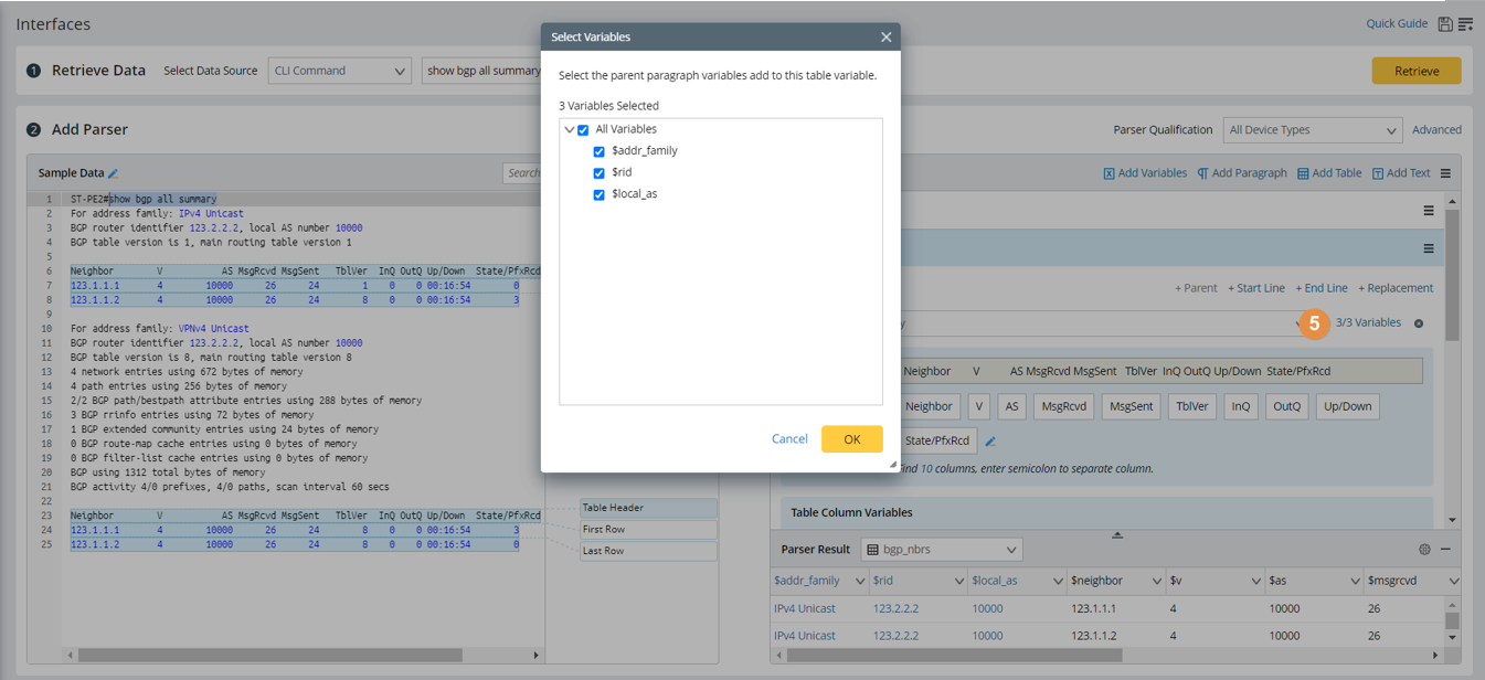

5.Click 3/3 Variables to open the Select Variable window. Select the variables to be inherited and displayed from the list(all variables are selected by defualt).

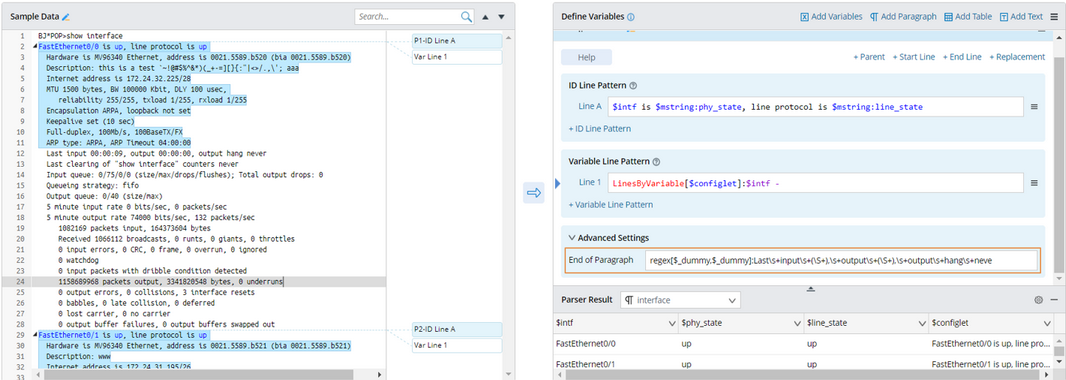

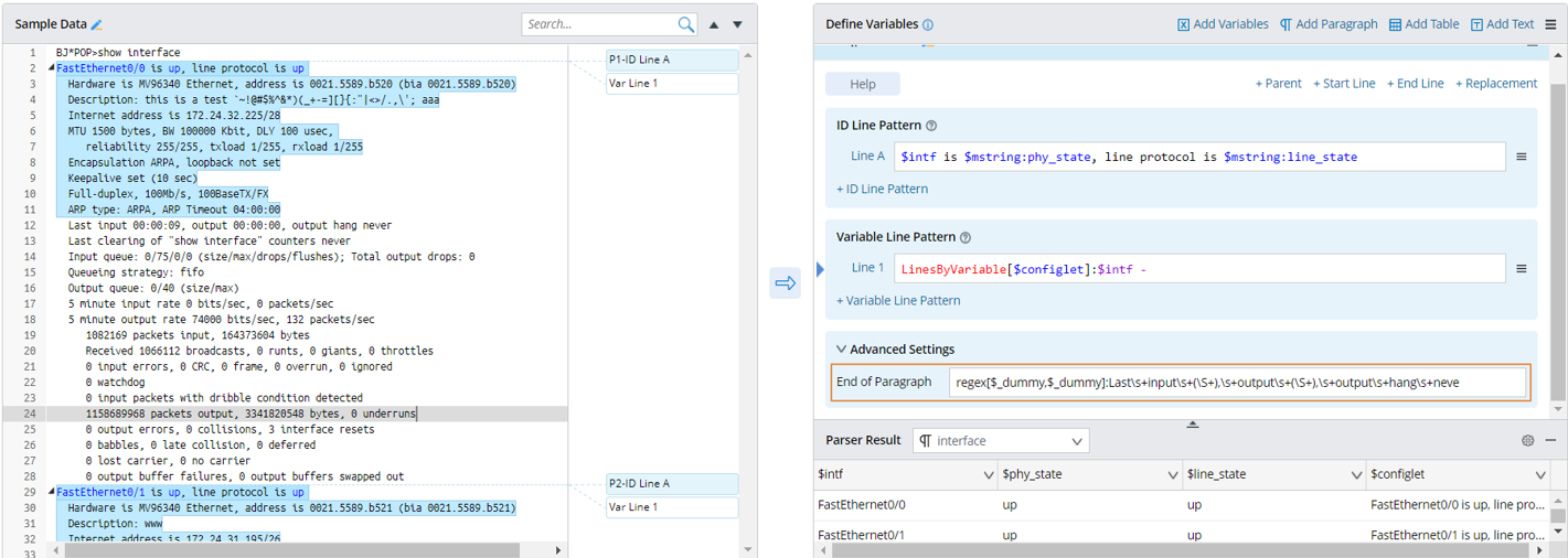

Add Definition for End of Paragraph
End of paragraph can be defined to narrow the scope of each paragraph for more accurate results. This is especially useful to parse the configlets in paragraph parser. The diagram below shows the order in which parser rules are applied:
When there is no end of paragraph defined, or there are no matched lines found for end of paragraph, the matching scope for variables is the whole paragraph. Single-line rule or regular expressions can be used to define end of paragraph. It is not recommended to define variables in end of paragraph as they will not be parsed and will be treated as dummy variables.
There are two ways to define the end of paragraph. An example about how to define the end of paragraph for CLI command show interface in two ways is as follows:
Option1: Select the target line of text in sample data and click the icon to duplicate it at the End of Paragraph field.
Option2: Use regular expression to define end of paragraph.
In this example, the parsed configlet will stop before end of paragraph for a more accurate result:
