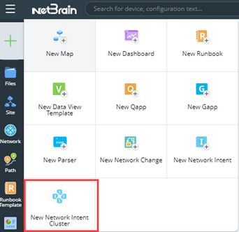

Input Devices are the network devices associated with Network Intent Cluster.
1.Click and select New Network Intent Cluster.
2.In the Network Intent Cluster Manager window, enter the name and description for NIC.
3.To define input devices,  click Input Devices > Select Devices.
4.In the Select Devices window, select the input devices.
Tip: You can also add by device group or by site.
Tip: You do not need to be too specific about the input devices, as they can be filtered later with the device classifier node.
