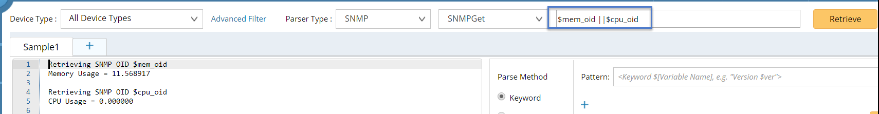

5.Enter the following two OIDs in the Command field and separate them with ||.
Free memory OID: 1.3.6.1.4.1.9.9.48.1.1.1.6.1
Used memory OID: 1.3.6.1.4.1.9.9.48.1.1.1.5.1
Note: Only the SNMP method SNMPGet supports multiple OID inputs while SNMPWalk and SDNMPTable supports single OID.

Note: SNMP Parser has two special built-in SNMP parameters: $cpu_oid and $mem_oid, representing the CPU and memory usage of a device respectively. When you use these two parameters in the Command field, select a device to retrieve data, the system will automatically to get the CPU usage and memory usage by looking up the corresponding OID of the device in the domain.
