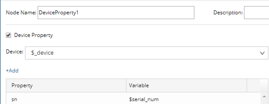

11. Define the Device Property1 node as follows:
1)Keep the default $_device option in the Device field.
2)Click Add in the Device Property pane. The application property is displayed by default. Point to the application cell and select sn from the drop-down list (sn means the serial number).
3)Point to the cell under the Variable header and select $serial_num from the drop-down list.

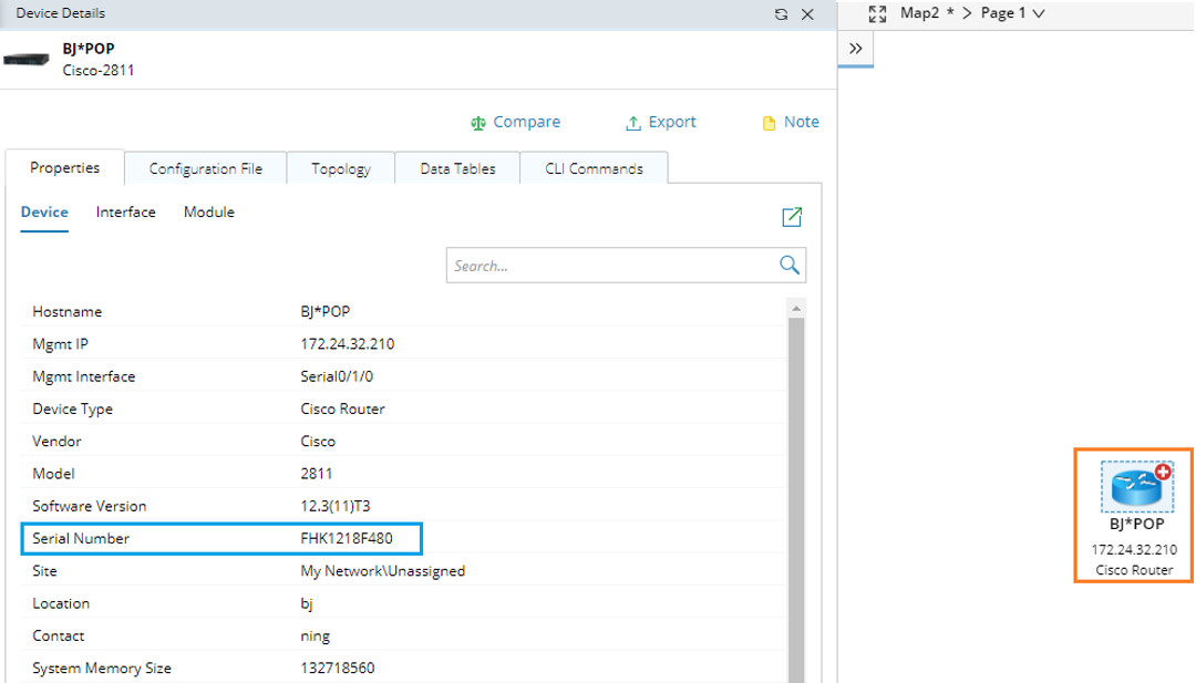

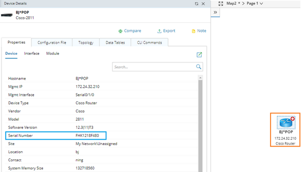

12. Save and run the Qapp on a map with Cisco IOS switches included. Once the Qapp execution is finished, double-click a device to view whether the Serial Number field is populated in the Device Details pane.
