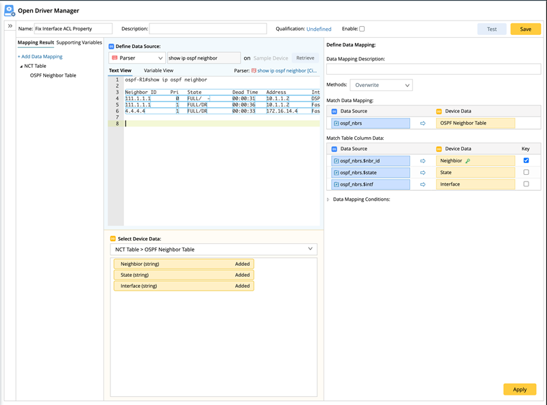

Follow the steps to create a new NCT table via Open Driver:

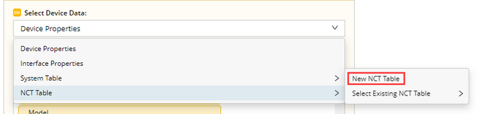

1.In Open Driver Manager page, select NCT Table> New NCT Table.

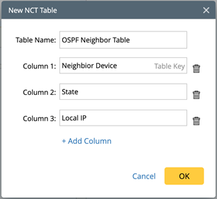

2.In the New NCT Table window, define the table name, column names, and set one column as the table key.

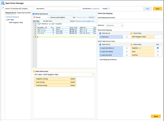

3.Enter a CLI Command and define its parser to fill the NCT Table.
