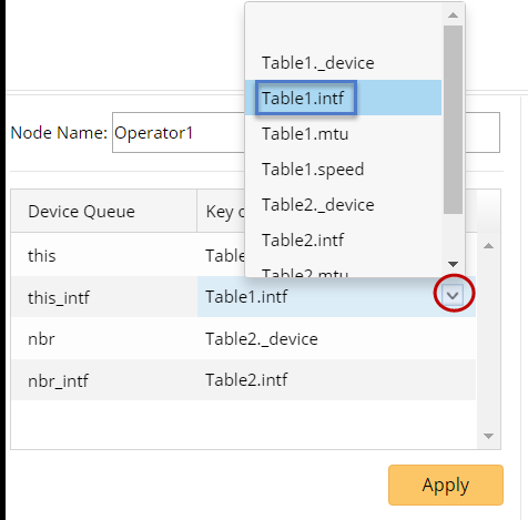

2.At the Neighbor Join node, adjust the matching keys of two tables based on the variable name in the Device Queue node. If a variable is incorrectly matched, point to the key and click the icon to select a new key.

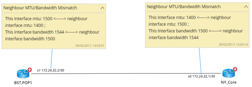

4.  Extend a Draw Note node from the Output1 node and define it as follows:
1)Unselect the Map Note check box, and then select the Interface Note check box.
2)Select $this_device in the Device field, and then select $this_intf in the Interface field.
3)Enter the title of the note: Neighbor MTU/Bandwidth Mismatch.
4)Enter the content of the note. For example:
This Interface mtu: $this_mtu <------> neighbor interface mtu: $nbr_mtu
This Interface speed $this_bw <------> neighbor interface speed $nbr_bw
5.  Save and run the Qapp on a map. After the Qapp execution is finished, devices with mismatched MTU or bandwidth value will be attached with a note.
