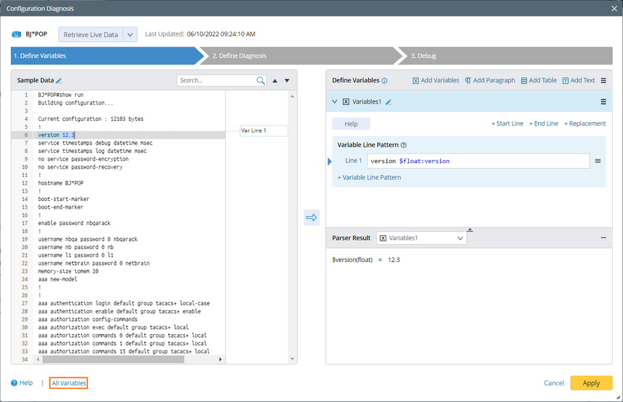

1.In the Define Variables tab in Network Intent edit mode, click Add Variables to define variables, then click All Variables.

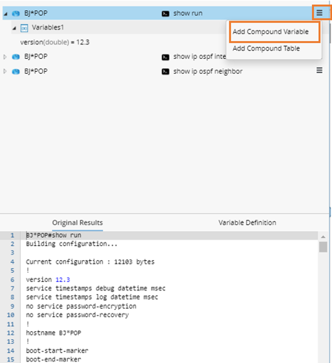

2.In the pop-up window, click the
button and select Add Compound Variable.

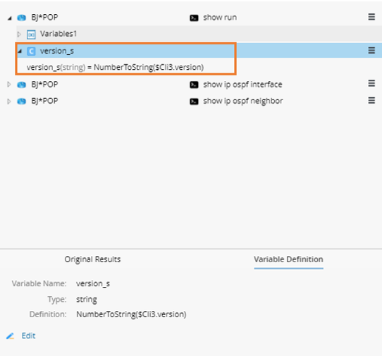

3.Define the Variable Name, Type, and Definition for the Compound Variable.
▪Name — Name can only contain letters, numbers, and underlines, and can only start with a letter or underline.
▪Type — The selection of the Type should be set according to the data type actually returned by compound variable or formula.
▪Definition — The Definition input supports two ways, one is mathematical operation, such as $var1 + $var2; the other is to call functions and see Appendix: Supported Functions in Network Intent for list of supported functions in Network Intent.
4.Click on OK and the Compound Variable is added as a new variable.
