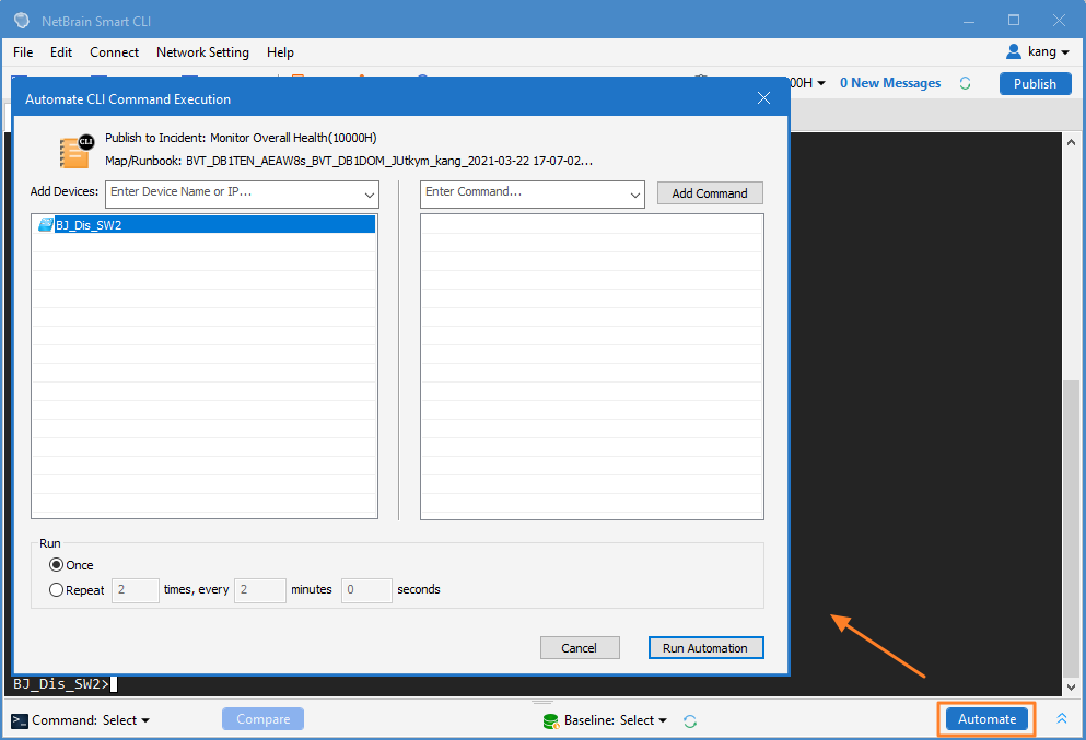

1.Click Automate in the Smart CLI.
2.In the Automate Command Execution dialog, complete the following steps to automate the command execution.
1)Select devices. Enter a device name or IP address and then select the matched device from the populated drop-down list. You can also directly select incident devices if an incident is associated.
2)Add commands for selected devices.
3)In the Frequency area, set the frequency for the command execution. By default, the Run Once is selected.

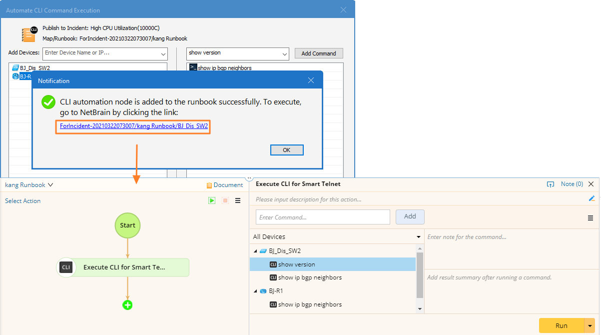

3.Click Run Automation. In the Successful dialog, click the created map/runbook link to switch to the IE system for your further operations. The defined device and command will be added to the Execute CLI node of a runbook.
