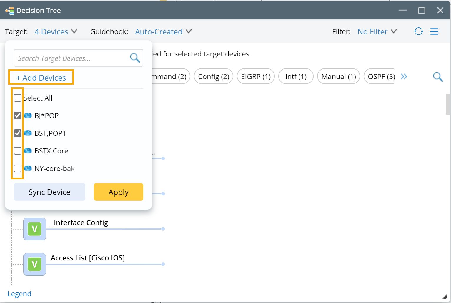

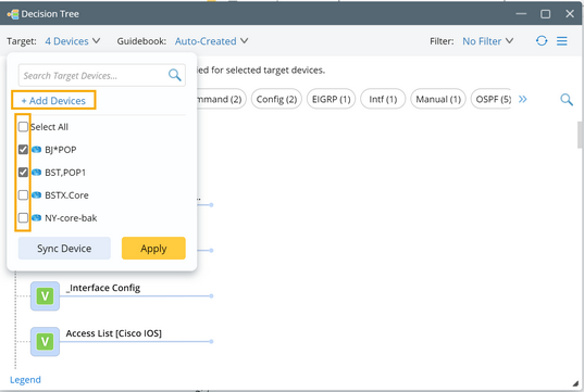

You can customize the target devices:
•To select/deselect the checkbox of current devices, and click Apply.

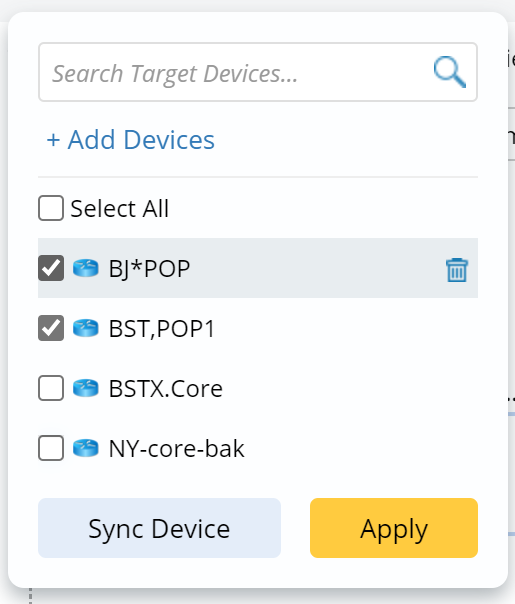

•To delete device(s) from Target Devices of the Decision Tree:
1)Hover over the interested device, and click
2)Click Apply.
Note: Deleting device(s) will NOT delete devices from the current map.
•To add device(s) outside of the map to Target Devices:
1)Click +Add Devices.

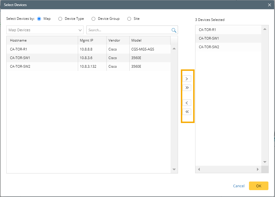

2)In the Select Devices window, select the desired device, and click
or
to add/delete the device(s) to/from the Devices Selected list. To click
or
, to add/remove all devices to/from the Devices Selected list.

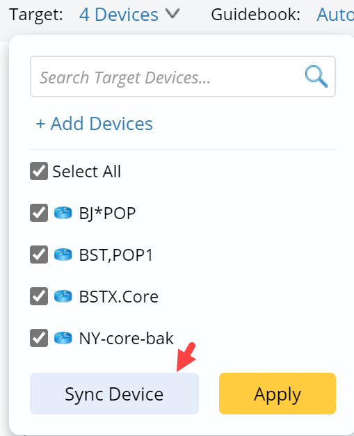

Tip: If you want to quickly switch the Target Devices back to the devices in the current map, simply click Sync Device.
3)Click OK and Apply.
