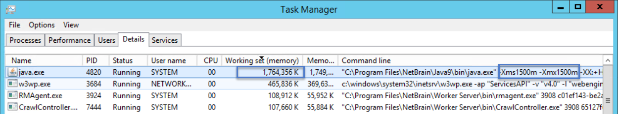

3.Open the Task Manager to restart the Task Engine service. On the Details tab, check whether the currently used memory is reasonable with the heap size change.
