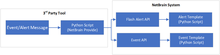

In order to support the integration with the 3rd Party Tool to obtain Alert information, Alert Template can be used to process the communication with the 3rd Party Tool and perform subsequent analysis of the retrieved data.
1.The script installed in the 3rd Party Tool is required as it defines how to log in to NetBrain system as well as the necessary header and message information of the alert that will be sent to NetBrain. In order to ensure the data can be processed successfully, the header information must follow the formats below:

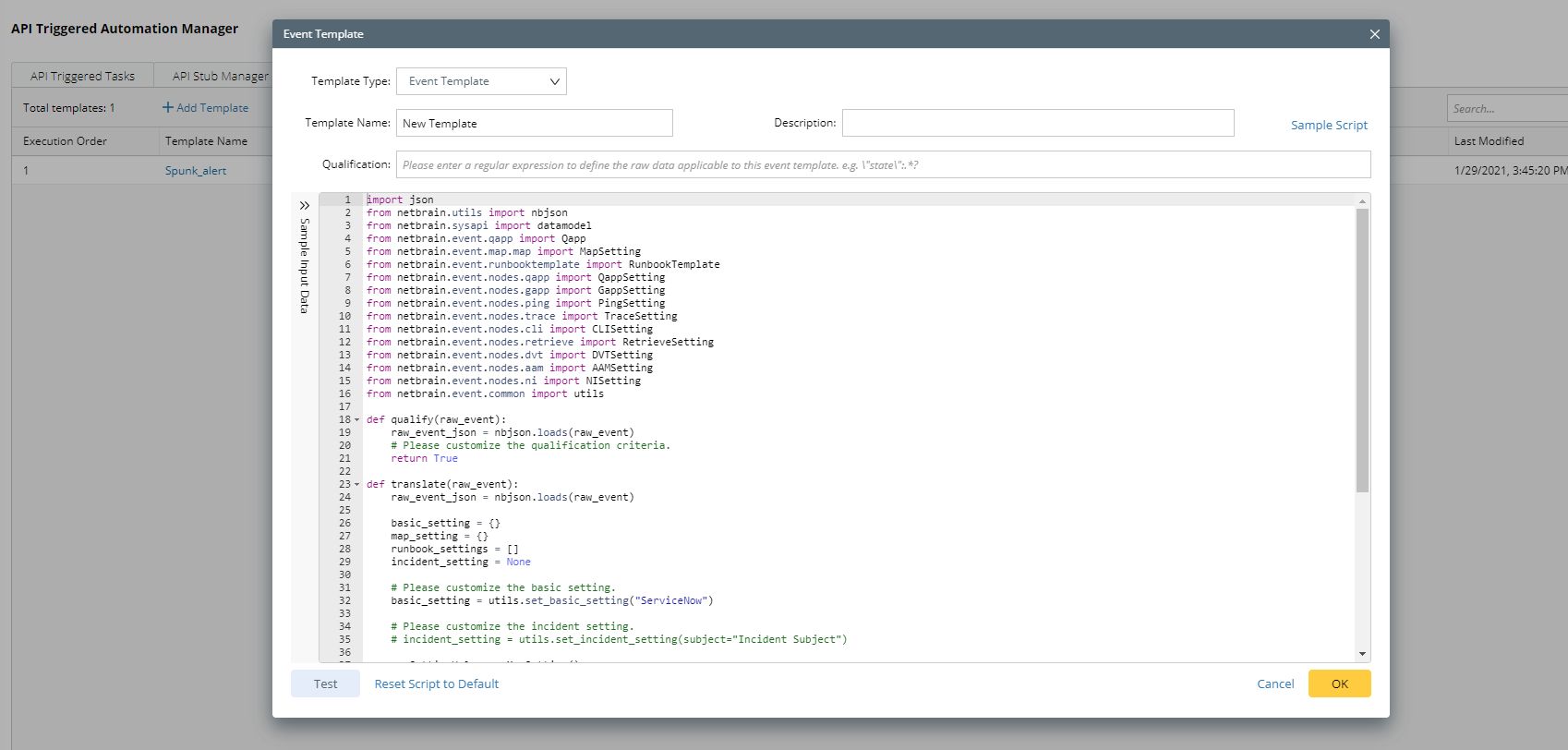

2.Add an Alert Template from API Tiggered Automation Manager > API Trigger Template Manager to qualify/parse the received message and call other system functions.
The Alert Template is used to parse the required information to generate Flash Probe and Flash Alert from msg, including:
Alert Name: As the key to generate and search the Flash Probe in Adaptive Monitoring, the Alert Name shares the same value with the Flash Probe Name.
Device/Interface Info: Device and Interface data retrieved from the Alert/Change Information.
Time: The time when the current Alert occurred.
Alert Content: The Alert Content will be displayed when the corresponding Execution Tree is activated.

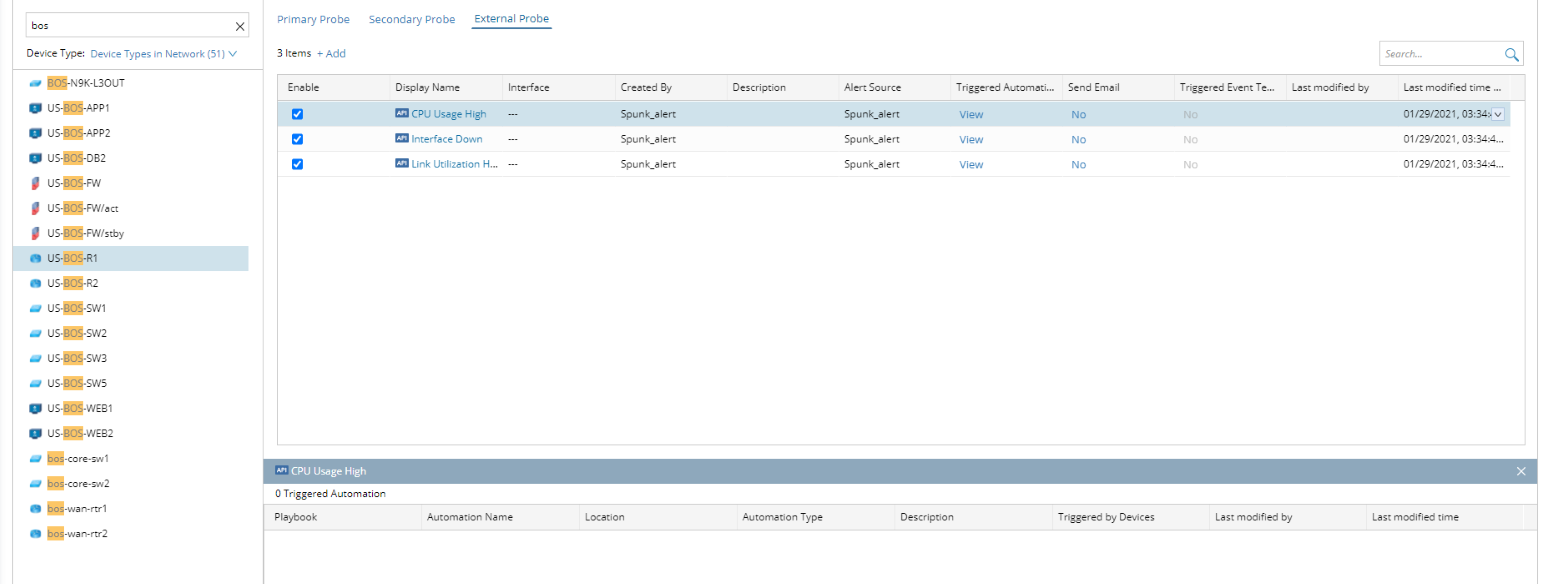

3.The Alert received from the 3rd Party Tool will automatically generate an External Probe, which can be viewed in Proactive Automation Manager > Adaptive Monitoring > External Probe.

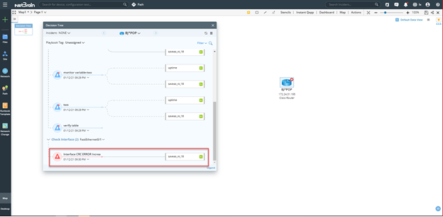

4.If follow-up automation is defined for External Probe, you will be able to view the detailed information in the Execution Tree once the alert is received. Refer to Viewing Flash Probe Results for more details.

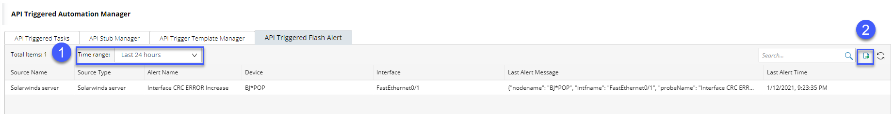

The Alert information received from the 3rd party Tool will be displayed in the API Triggered Flash Alert tab.
The definitions of each property column are listed as follows:
Source Name: The value of the sourceName field retrieved from the header information.
Source Type: The value of the sourceType field retrieved from the header information.
Alert Name: The key of the Alert, which corresponds to the Flash Probe Name.
Device: The hostname of the Device that generats the alert.
Interface: The name of the corresponding Interface of an interface level alert.
Last Alert Message: The most recent Alert Content of the Alert.
Last Alert Time: The time when the Alert was last generated.
Alert Counts: The total counts of the alerts. (Note: This property is only for display purposes and does not support clicking to view more details.)
Tip:
1)Viewing alert based on time range is supported.
2)Export operation is supported- you can export the contents of the current Table to CSV File.
