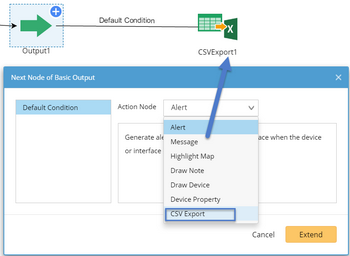

1.Extend a Basic Output node from the Table2 node (Global Data Table). At the Output node, you can set conditions to trigger the defined output. You can also use the default condition True, which means if the version exists.
2.Extend a CSV Export action node from the Output1 node.
